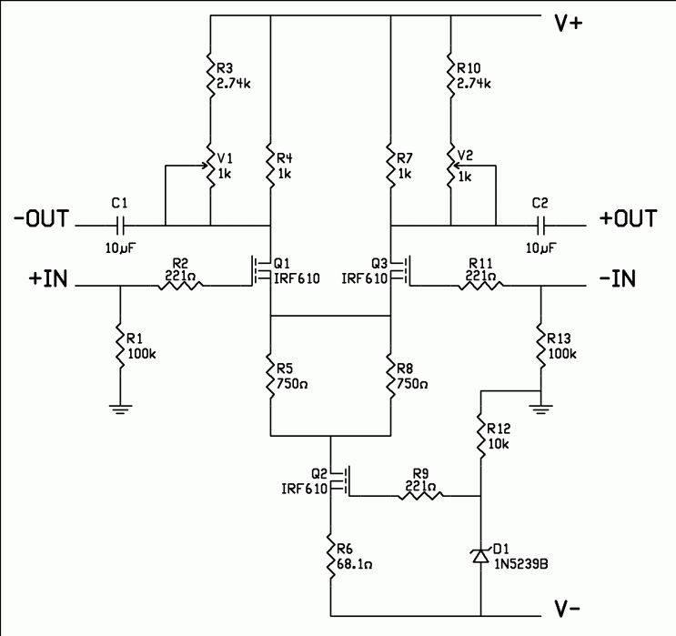

So my Phase Splitter-Buffer proposal wasn't that bad at all, don't you think, especially if I remind myself about what you will use after this little fellow.
Hi Andrej! Oh, I like your design plenty. But it is far beyond the budget for this amplifier.
Well, I'm not sure exactly what this means, but I could certainly manage to assemble an extremely compact design.You will want 3 resistors that must connect to the MOSFET
gate to come together close enough that all act as stoppers...
You don't want a long stub of undamped wire hanging on
that MOSFET gate to resistors located far away...
I'm absolutely clueless on that one. Would you mind illustrating more?I don't think the JFET follower gates need stoppers, the drains
aren't going anywhere, and the sources follow at unity. Still,
100R on those gates probably wouldn't hurt anything. And
maybe a small bypass cap to GND at each JFET drain, just
so nothing layoutwise allows those drains to wiggle..

There is ~52vdc available. For less than that, there's regs.This circuit biases itself to accommodate most JFETs and maybe some of the higher transconductance twin triodes
if you were to give the rail here a bit more voltage...

He is right. Put the gate stopper resistors RIGHT up to the pins. Did you know that the same thing goes for the -In pins of chipamps and opamps, usually? You don't want ANY stray inductance, there. Otherwise, tiny little resonant tank circuits can be formed and you can get very high frequency ringing, or in some cases maybe even oscillation. So both feedback and series input resistors should be RIGHT at the -In pin. If there is no series input resistor for -In, but there is a conductor to it, then ADD a small-ish series resistor, right at the pin.
As seen on the MooseFet, ferrite beads were use to help promote stability and they are available so tiny as to barely encircle one leg of IRF510. Would you want to employ something like that in your design? Well, I'm asking because I don't know.
Beads as stoppers work great in switching circuits that don't mind
inductance causing a little overshoot. And where ringing after the
fact exceeds the frequency to become resistive and lossy. And the
closed loop rolls off at a far different, much lower frequency than
the signal of interest.
I don't think they have a place in the closed loop of an audio circuit.
Even a small inductance can make a closed loop become unstable.
And not at high enough frequency to trigger a useful loss... This sort
of loop is different because it closes at higher frequency the signal
of interest.
Its fine to use them as low pass output filter after the loop is closed.

But I still don't get why one channel entirely N, and the
other entirely P? Feature looks leftover from before you
had given up on making a jfet phase splitter and threw
a transformer at the problem.
If we use transformer to split, why do we want JFETs
afterward? Its just reintroducing DC offset we have to
get rid of with caps or another transformer. Put your
jfet up front if you are determined that a transformer
is the way to go... It only needs one jfet with primary
winding under the source...
Lets make it complicated for no reason... I agree with
your last statement that transformers alone without
additional buffer is the surest way to avoid problems.
I don't see any reason that simple wouldn't work.

As for the FET splitter, I think the IRF510 might have
been an overkill choice. VN2222A is a smaller MOSFET,
and less capacitance, but still do the job. You might
could even use this for all three FETs...
And ...Feature looks leftover from before you
afterward?

But I still don't get why one channel entirely N, and the other entirely P?
Because I simply didn't like how only N or P fet's schematics looked. Our work here must be treated like a work of art, just like a great paintings and that's how I look to our DIY love affair. 😀

Maybe you could try the dual OP275 "inverter-follower" differential line driver circuit that's shown in Figure 6-54, which is in the downloadable PDF of chapter 6 at ADI - Analog Dialogue | Op Amp Applications Handbook . (Of course, other opamps could be used, instead of the OP275.)
You could also look at the topology in Fig 6-96 (and 6-120, for future reference).
No circuit from me!
You are not splitting anything, you are inverting
It is not phase, it is polarity
It is splitting 360 degrees of phase into 2 180 degrees out so the 360 is getting split into two. I have always heard it called phase splitting for 31 years+.
