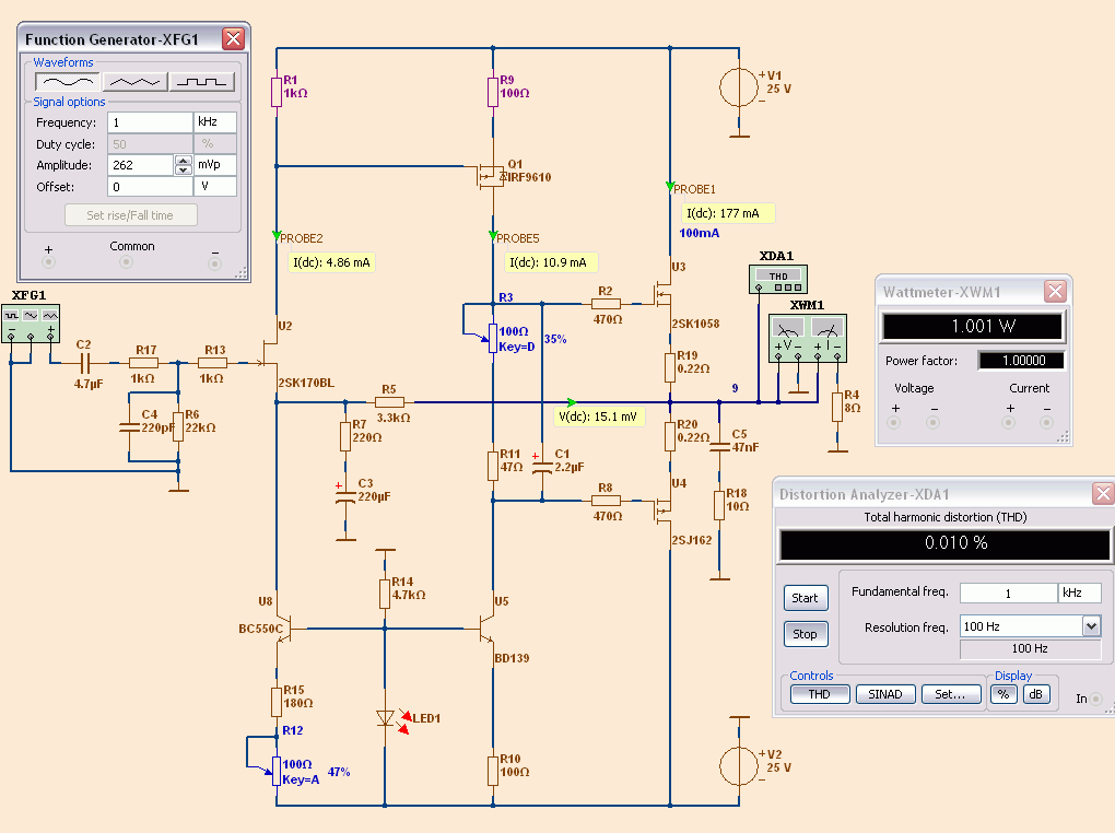

That test was temporary Fetzilla with no emitter resistor for IRF9610
and the feedback divider was the lowest: 150/10 Ohm. (gain x15)
Such an amplifier has got high OLG, and so need compensation.
If you try the official Fetzilla with THD 0.010%
you will notice it has more H2 than H3.
HERE IS THE OFFICIAL FETZILLA

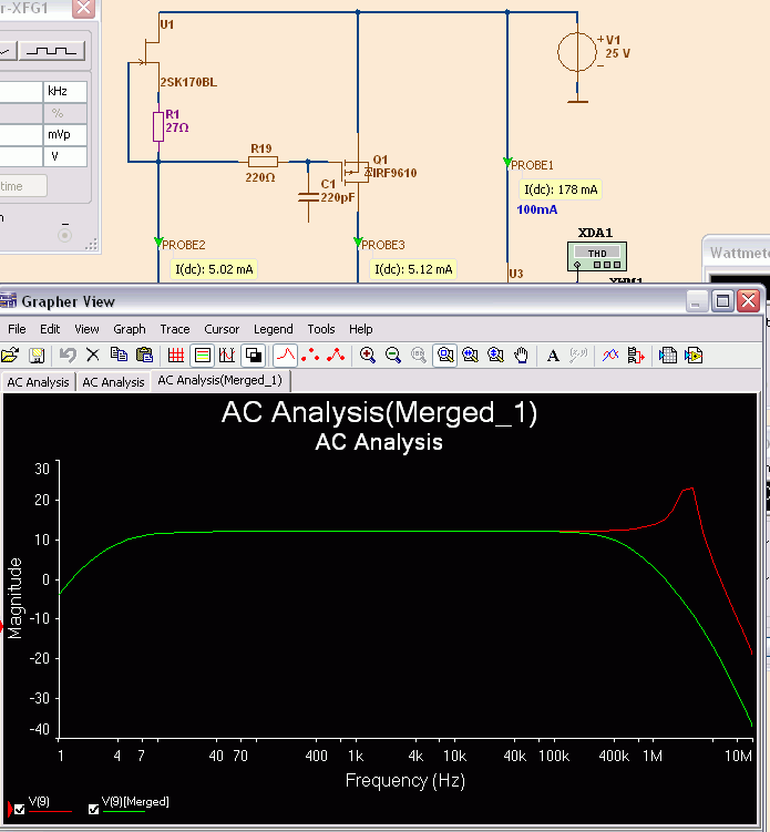

How do you determine which compensation is right...??
Can you do that in simulation.. Don't you need real circuits for that..??
I do AC analysis.
If there is an overshoot in AC curve, we can guess circuit is not stable.
On previous page I show how to use AC analysis.
True is that a real circuit seldom match the compensation done in SPICE.
But to compare 2 things is possible in SPICE. The relative value.
For example I had posted a circuit with 22pF
Danspy got oscillations until he useed 100pF.
So, compensation in SPICE has got a value on its own.
But should not be confused with a real circuit. At least when it comes to compensation.

H2>H3>H4....
Regarding stability and compensation.
We have noticed that amplifiers of Hiraga, JLHood, Nelson Pass
not often has got compensation capacitors.
When you build you need not much worry about stability.
Classical Amplifiers of these gentlemen are most often without comp caps.
But they are mostly not ultralow in THD distortion.
Even sometimes compartively high THD. Within a limit of course.
To sum it up, a good classical amplifier has got moderate open loop gain.
From this follows a moderate feedback level.

What I like to know is if 'official' is stable and good WITHOUT any comp cap.
My thought is that people who build should not have to worry about oscillations.
You could run some squarewave at 1kHz and 20kHz.
If needed I will change to feedback divider to higher values.
Do it when you have time.
Here below is latest official.
And the AC Analysis curve that shows no 'overshoot' of the circuit.
The curve is done without input filter 220pF
