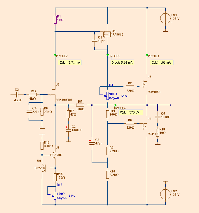

I don't get the Fetzilla with 2SK30A to Work, and yes there are some error in the Layout but i think i sorted most of it out on the Build.
Maybe it is something with the IRF9610 Pinout because there is none in the International Rectifier Sheet, only in the Vishay one.😕

Well done for being the first to build something. I'm sorry it's not working.
The vishay and irf pinouts will be the same.
Now, first things first.
1) How much current through your input fet? (What is the size of your drain resistor and how much voltage is across it?)
2) How much current though your VAS? (What is the value of your bias resistance and bootstrap resistors and the voltage across each of them?)
3) What is the current through your output fet source resistors. (What resistors did you use and what voltage is across them?)
4) What is your DC offset?
5) Are any devices getting hot?
6) Which schematic are you using exactly?
Let us know these things and we'll go from there.
Greg.
1k and 1,5Volt
2,7/2,7 on +-28Volt Supply = 5mA
The source resistors are 0,1/1Watt Dale LVR ad i get 3,5mV true them at every Time, an no increase or decrease wen i turn the Pot.
-26,6Volt😱
No
http://www.diyaudio.com/forums/solid-state/186650-jfet-input-mosfet-vas-lateral-output-perfect-18.html#post2562232
The schematic would be the one with 2SK30ATM
You should turn R12 the potentiometer until
yoou get more than 1.5V across the drain resistor R1
and you get zero DC-offset on the output.
1.5V at the gate of IRF9610 is too little.
Should be more like 3.8V

Danspy,
The first thing is to check your layout very carefully, which I can't do, but we'll assume it is correct for now. BTW, can your jfet handle a 28v supply? Most are rated at 25v.
Then do this:
1) Set R3 to minimum value. This will prevent fets from turning on too much and blowing themselves up while you're adjusting. Also set R12 to maximum value. This will prevent destruction of input fet and VAS fet by keeping current of input stage low. Now turn it on.
2) Measure voltage on VAS inbetween R3 and R11. It needs to be close to 0 mv (only for now, we will change later).
If it is higher than 0mv you need to increase R12. This will decrease the current through R1, which will drop the voltage across it and turn on the VAS fet less, bringing the midpoint VAS voltage down.
If it is lower than 0mV you need to decrease R12 which will have the opposite effect. This is the situation you are most likely currently in.
If you run out of adjustment for R12, you may need to increase R1. However, currently you are only running 1.5mA, so I don't think this should be a problem. You want 3.5mA or so.
3) Now, move your voltmeter to the output and double check the DC offset at the output.
4) Put your voltmeter across one the the output source resistors. Now, depending on whether you want to run class AB (100mA bias) or class A (1A Bias), adjust R3 until you get 10mV across the source resistor for class AB or 100mV for class A.
5) Now, check your DC offset at the output. It will be off again due to the different Vgs of the mosfets. Adjust using R12 as described before to get it as close as possible to 0v.
6) Double check your current through R1. It should be no more than 4mA - (4v across it).
7) Double check your VAS current. It should be no more than 5-6mA or so max (11v across the bootstrap resistors).
8) Double check current through source resistors for output fets.
You should now have a working amplifier!
Hope this helps!
If you still have problems let us know.
200mA! Wow, something is very wrong. How are you measuring this exactly? What voltage is across R1?
Ok, first things first. What is the voltage rating of the jfet and your rail voltage? It is possible you have exceeded its supply voltage and it is shorting out. I can't find a datasheet, but most audio jfets are 25v. I think you were using 28v rails so this will be a problem.
If this is the case you will need to make the cascode version to keep the voltage at the drain to 14v.
Otherwise, maybe you have the wrong pinout for the CCS transistors and the CCS is not working properly.
I try,t to Bypass the CCS with a 5k Pot, and den smoke came from R7.
Den i got the CSS back on Line and measure,t 11Volt over R7.
The 2SK30ATM teaks 50Volt and 100mW.
And the CSS with the BC550 Pinout CBE with the flat side up woks fine.
Danspy,
R7 is connected to ground through a capacitor which means DC can not flow through it. No current should flow through R7 unless a signal is applied. So the are two main possibilities.
1) you have an error in your construction.
2) C3 is shorted due to reverse polarity or connection. You may need a bipolar capacitor here. You can use two back to back electrolytics as a substitute.
