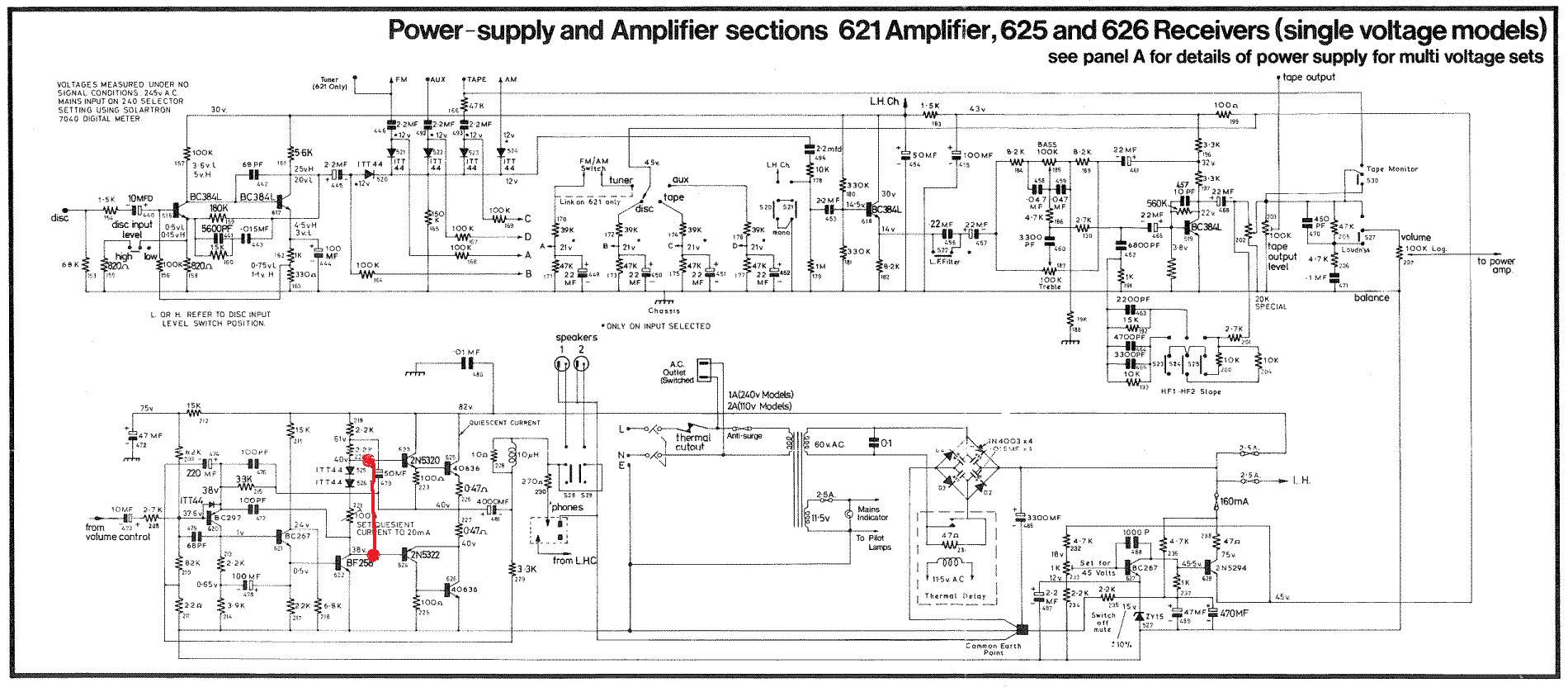

Many thanks for the info, I will have a good read of that. I have an old but working 15Mhz scope so will check for distortion. My 625 has been repaired by Armstrong in 1989, the 40636's have different codes on one channel and the drivers have been changed for 2SB861/2SD1138, I have the repair bill from Armstrong to match. Is it worth changing these for TIP41C/TIP42C.
There is a single main smoothing cap for both channels and the pre-amp circuit, it also might be worth separating these out per per power amp channel and a 3rd rectification circuit for the pre amp power supply. With it being a 625 there is a fair amount of space in the case.
I've also noticed mine has 1000uF caps on the power amp board, I haven't traced these through yet but they appear to be the feedback caps, the schematic that is commonly available for the 621 has 220uF feedback caps.
2.2uF electrolytics are primarily used for the signal path caps, I have some nice Sanyo 3.3uF 50V bipolars which I will probably used in place of these. Given I only paid £8 plus postage for the amp, I am not strict about keeping it original, I'd like to make some sensible mods to improve performance and make sure it can last another 43 years.
The phono stage is a little noisy and the BC384L used only have a 4dB noise rating, I will probably change these for KSC1845. I'd also like to improve the regulator for the small signal circuits but I need to find a circuit that can regulate from 80V down to 45V, my usual LM317 tracking pre-reg circuit can't handle those kind of voltages and thats probably too high a working voltage for the Salas shunt reg to operate at a sensible power dissipation.

Do not move the main audio ground to the PSU.One thing I have noticed is that all four speaker returns go to the GND on the pre-amp power supply and not the main smoothing capacitor, which isn't ideal at all so I will probably change this when I am working on it.
The 2SB861 has a Cob of 30 pf and Vceo of 150. I presume the 2SD1138 is similar, I can't buy these. Those are quite competent, probably a lot faster slew rate than a TIP41/42C. If no SOA rating on 2sb/sd transistor worries you, put a little heat sink on the drivers. One of my ST120 channel had original 5 digit RCA TO5 drivers, the other some RCA SK generic TO220 transistors from 1985. I'm sure the TO5 ones were quite slow, but I didn't hear any difference between the channels not even on top octave solo piano. The big HF benefit seems to be faster output transistors than 200 khz. That audible performance is with my 20-14000 hz ears and the 54-14500 hz +-3db Peavey SP2-XT speakers. I use a real Steinway piano as reference for amp and speaker tests.
I changed my input caps to tantalum in 1985, which added bass and also added frying pan sizzle. They might have been rejects as sold by the local TV parts store. I changed to 4.7 uf 50 v ceramic caps in 2009 which was a great improvement. Lower voltage would lead to more non-linearity of the dielectric. Bipolar 50 v 3.3 uf electrolytic caps could be fine sounding but limited in life to ~ 20 years after you bought them. I detest replacing e-caps, I've had to do the dynaco ST70 4 times since 1970 and these 1964-68 organs I play have consumed a couple of hundred new e-caps so far. **** e-caps deteriorate sitting on the shelf, even.
I find the single 3300 uf mains cap of my unit gives quite loud sonic peaks on 1.5 Vpp base level music. I did replace all e-caps in 1985. I can't say the 3300 uf is much of a limiter for 20 millisecond or so of a drum hit. For long term high power the heat sinks and the SOA rating of the single transistor pair are much more of a limiter than the cap resevoir.
For the 45 v regulator I find a zener diode to the base of a PNP transistor to be quite competent. The armstrong diagram has it correct. I just built a 72 v regulator for the rail of my ST120 based on this with 5 TIP142 pass transistor in parallel with .39 emitter resistors. The dynaco PC14 voltage regulator was incompatible with use with a test light bulb on the mains.
For eliminating noise on phono, I'd start by changing any & all resistors over 100 kohms to metal film. This took a lot of hiss out of my dynaco tube amp and preamp. The cheap multicomp and vishay metal film ones from farnell seem to be fine in the noise dimension. Noise increases with resistance, so I didn't bother with the smaller values. Of course my dynaco has mil-spec paint carbon comp resistors that don't increase in value due to moisture incursion like cheaper ones. An armstrong I don't know what your resistor value stability after 45 years would be.
Finally, if the update will put out 40 v drum/cannon shot peaks on room level classical (wide dynamic range) music, you might want to check your speaker tweeter that it will withstand that much. I blew a couple of voice coil tweeters just with a tube ST70 over the years, no cause found. I have mush more faith in these liquid cooled titanium diaphragm tweeters that came in the Peavey SP2-XT's I bought in 2010. Some pro PA speakers put a voltage surge supressor across the tweeter after the crossover to protect it from overdrive.

Thanks for the info again, I'll go over it a couple of times before I am ready to start.
I got a copy of the original service data and a very large set of schematics (the full version of the schematic commonly available on the internet) with my receiver if anyone is interested in them.
I have to start the same job soon on my 625 and i'd be very interested in the schematics you have if they show more [useful] data that the simple circuit diagram you've already posted.

Did you see #48? That is the power amplifier schematic. If you want to see more details and the Tuner sections, you can see them all and read the descriptions and FAQs at Jim Lesurf's great website as well: The Armstrong 600 Series - tuner FAQ and diagrams.
