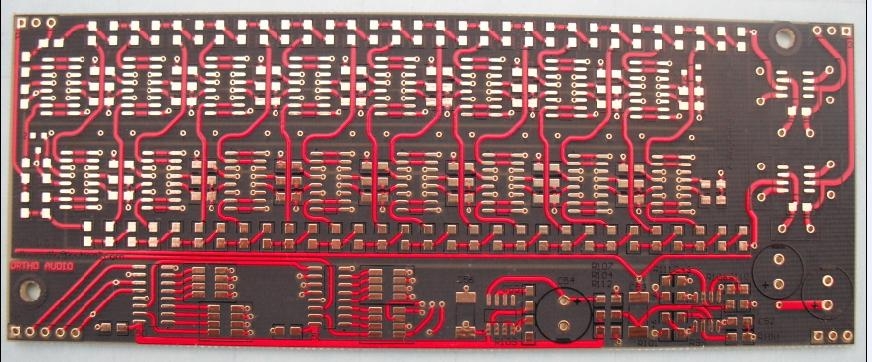

Many Hi-End manufactures prefer ultra high precision volume contorl, I design a volume control module based on 16 pieces DG413and a pair AD797. Thanks to Mark Levinsion's preamlifier No.32, the layout of my module is similar to No.32's. ^_^
4-layers layout is not an easy job >_<

Do you think, that this type is still the best choice as analoge switch?
Or perhaps is a solution with discrete MOSFETs is the royal way (as substitute for relais) especially for an audio high end volume control?

I will test and figure out the performance of the assemble module with Audio Precision System Two later, espcially the real performance in ultra-low level singal conditions.

Knowing someone who can test using ears would also help. I won't be too surprised if such an attenuator sounds better than cheap relays. But why opamps???
the OPAMP AD797AR here are used as I/V convertors, like the I/V conversion part of your DAC in the CD PLAYER/DVD PLAYER
because of the OP, the analog switches current but not voltage, that will help to 'protect' the original input signal, keep the signal in the module away from outer noise etc
I understand this. You probably won't do it but adding some extra pads carrying the output current and allowing the end user to choose their prefered I/V solution will broaden the interest towards your design. Some people are simply allergic towards opamps. Not to mention the tube crowd.
Still, a very nice design, probably way better than any 3310/2310/2320.
