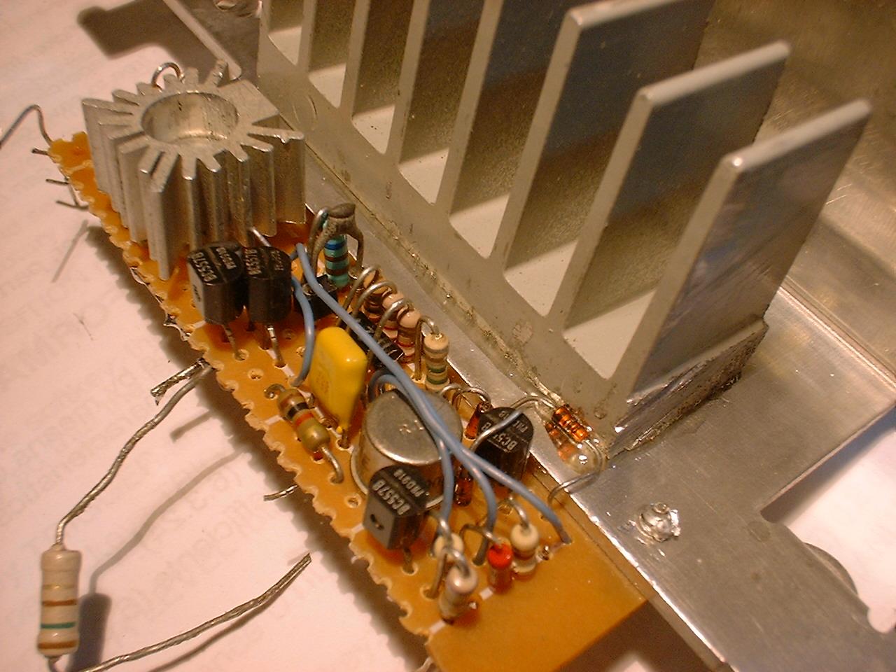

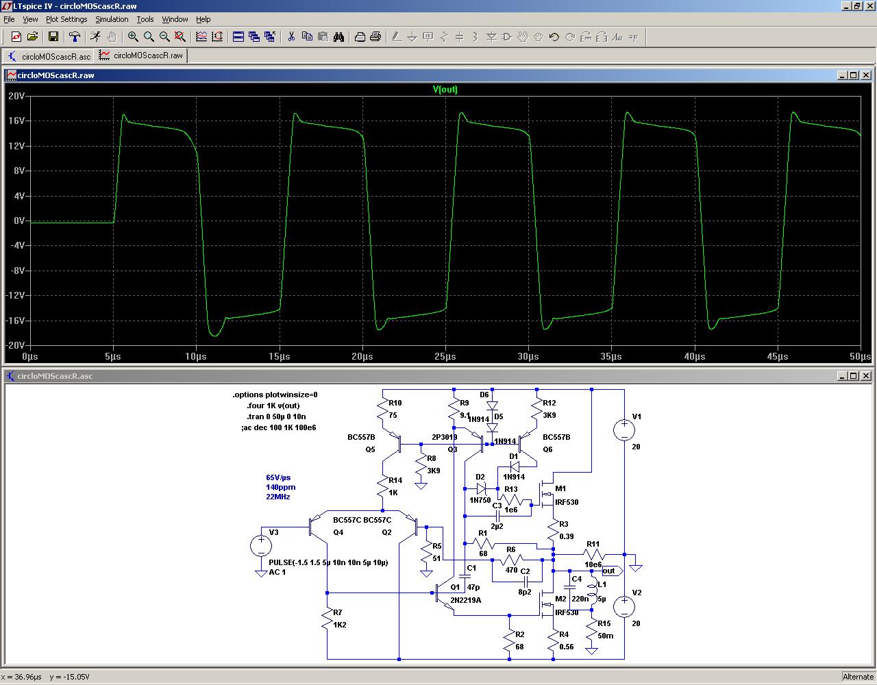

The Circloflop isn't dead yet...
....just on life support.

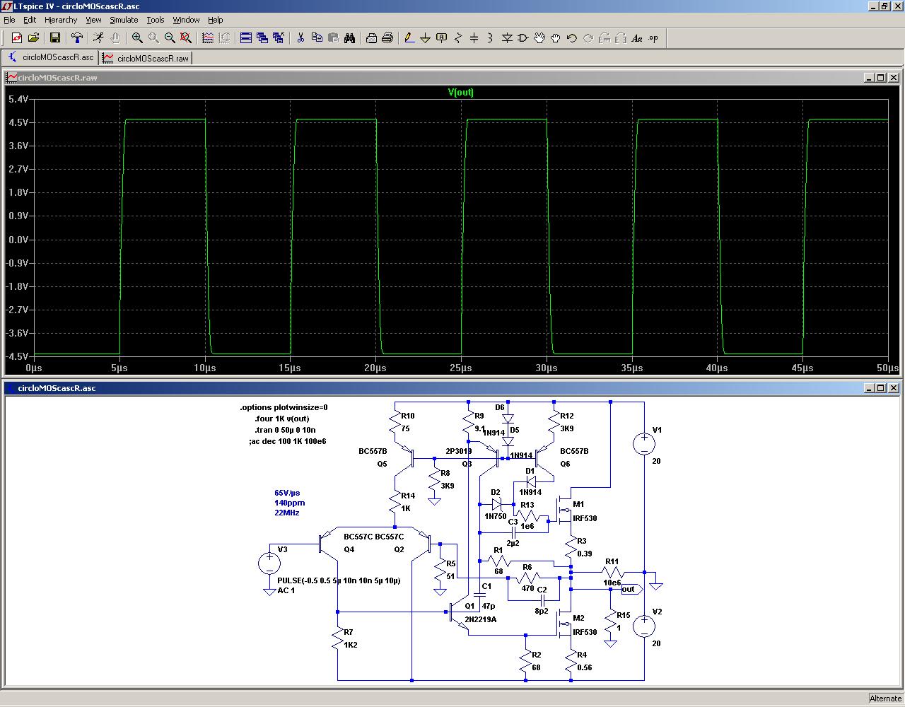

Here are some more pics:

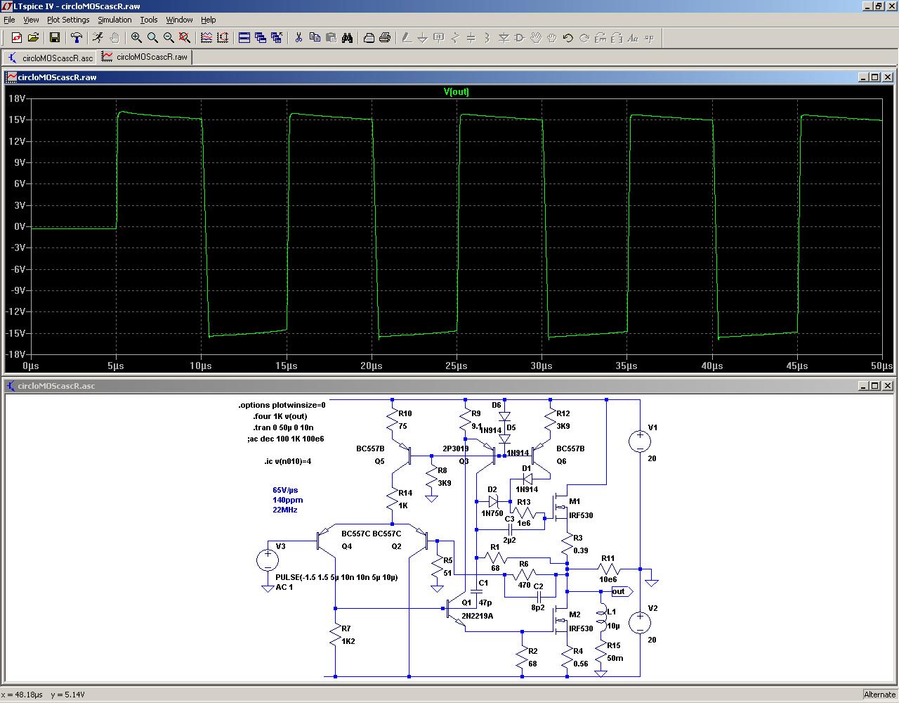

First the simulated response to a 100KHz square wave, on a pure capacitive 100nF load.
Second, the same, but in the real world (capacitor is Siemens polypropylene B32650, 0.1µ/400V)
It is a "lab workhorse", an all-purpose power amplifier, designed to drive all sorts of transducers (including loudspeakers), transformer, coils, etc, at various frequencies, from DC to ultrasonic. It also does stress-testing of components or subassemblies, to simulate load-dumping conditions f.e., or inject interferferences into power supply lines.OK, I'll bite - what's it for then, if "not intended for audio"?
This is why it has to be extremely stable, robust and tolerant, without any network in the output which might degrade the accuracy.
And it has to cheap, in case things go really wrong.
It operates in AB, under near-square law conditions (insofar as the transfer function of the FETs permits). The Iq is about 120mA, with a strong negative coefficient (in the sim at least: with real components, heatsinks and non-ideal thermal couplings, things are more even).Is it running in class A or B? - I haven't simmed it but the circuit looks like it could do either. Presumably something somewhere is adjustable to set the bias?
The bias could be made adjustable by making part of R12 variable, but I used no trimmers, and selected D2 instead.
D5 compensates for Q3 Q5 Q6, and D6 for the output transistors.

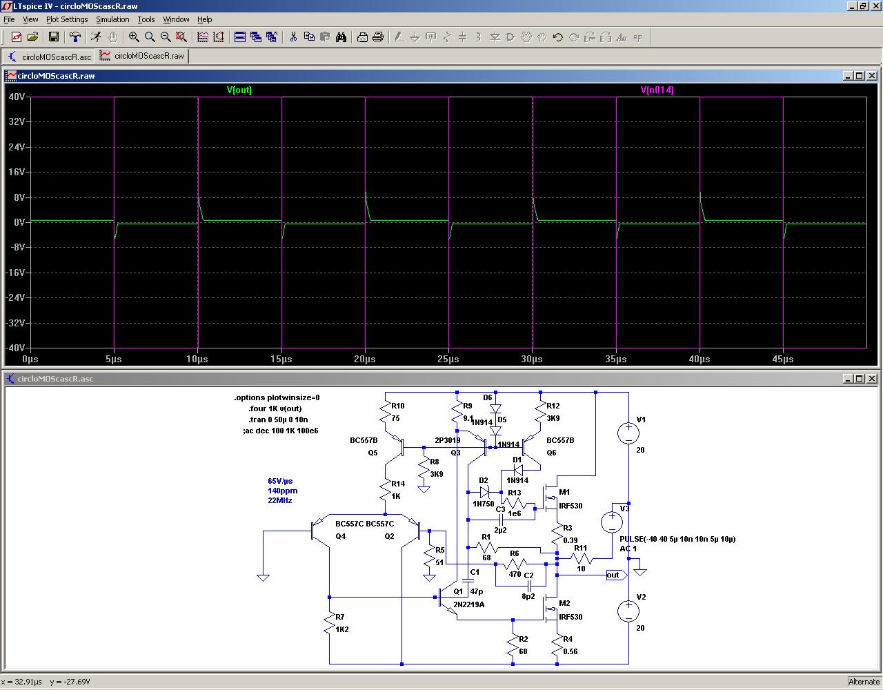

Some further details:
First, more stress-tests.
On a (quasi) pure inductive load of 10µH:
The load dumping condition: the load forces an 80Vpp, 100KHz square wave (magenta) into the output of the amplifier (green). That's twice the supply voltage of the amplifier:
Now, a low impedance test, with a 1ohm load (for obvious reasons, the voltage is limited to 9Vpp):
Next, the load is a high-Q parallel resonant circuit:

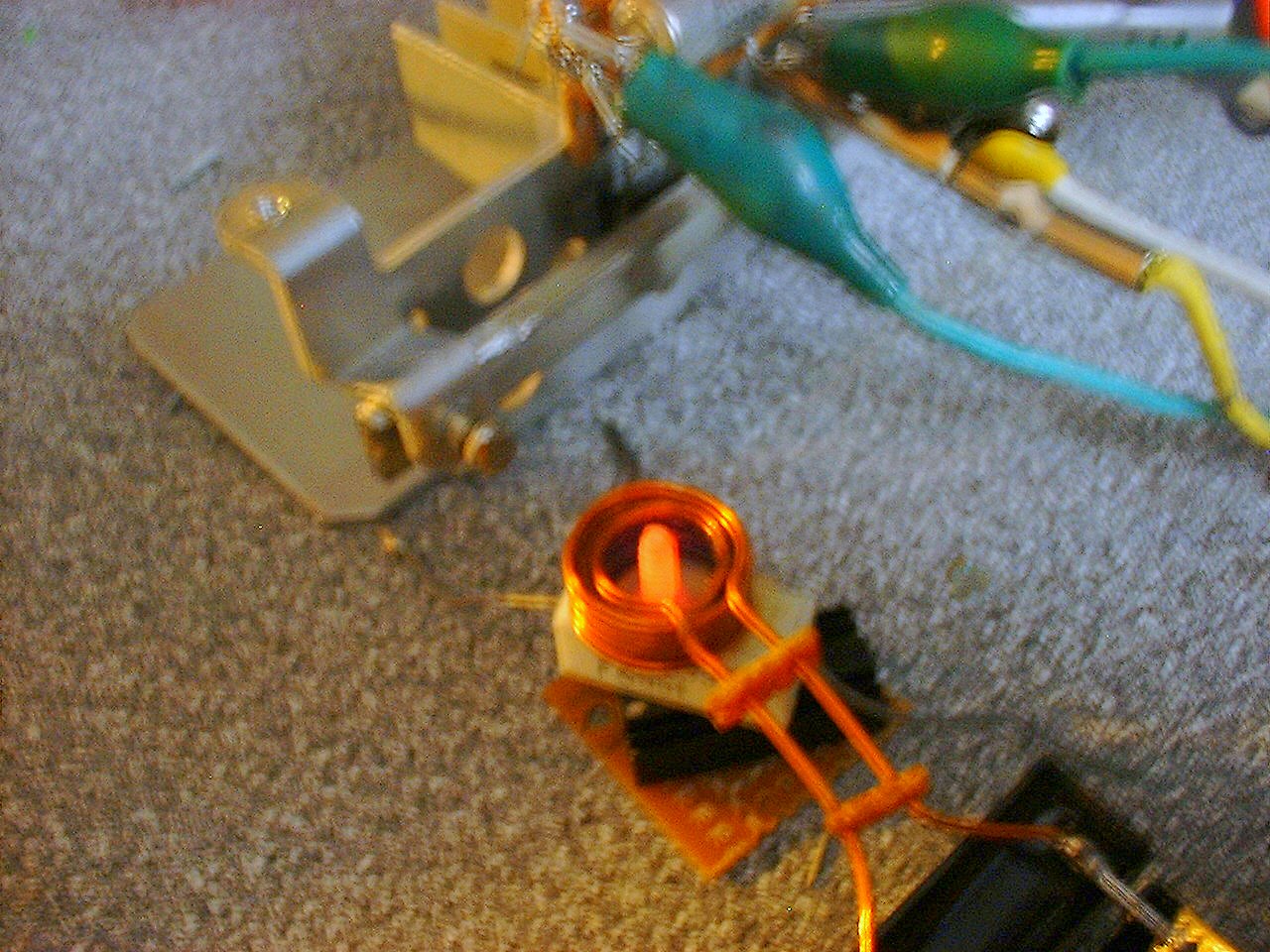

Here is a real-life application of the above simulation: inductive heating of a screw. First, the test set-up:
And then the thing in action:
(Sorry for the pic quality, the coil was beginning to catch fire)
A close-up of the prototype, showing the heading of the thread is properly chosen:

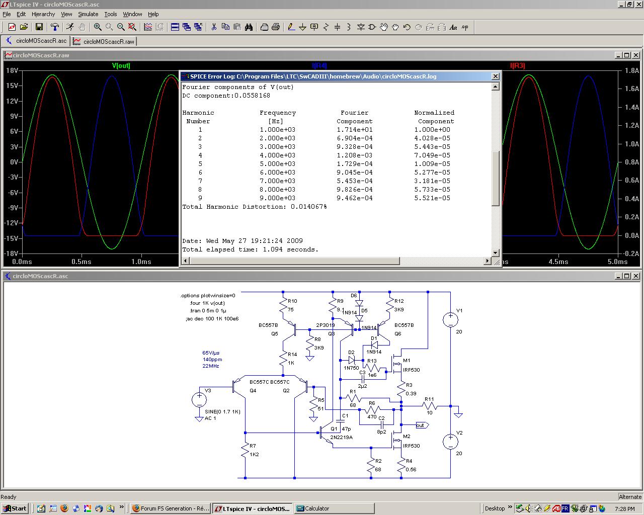

Finally, a more serious note: a look at the distortion:
This is the first time I see an audio amplifier doing that. At what frequency/amplitude is it?inductive heating of a screw
It should do well, but in this version, a transformer would still be necessary.As good as it is on difficult loads, wonder how it would do driving electrostatic panels? Should do well.

Congratulations, event horizon, you were smart enough to catch the main innovation of the design!I just love the way it can swing nearly rail to rail by the simple addition of a capacitor (2.2uf), as you know you'd normally need a higher supply voltage on the positive side.
This version has an output impedance of ~100millohm.Any idea on the damping factor? I should imagine it should be pretty high or certainly could be made to be so. With no output inductor it should it should be fairly high to high frequencies to.
At relatively low frequencies at least; at higher frequencies, you can have an idea of the behaviour by looking at the load-dumping and low-impedance tests.
But as you rightly conjecture, it is indeed possible to improve this factor, and I will also describe a more elaborate version doing about 20dB better on this point.

This is a very interesting design, and I really liked the picture of the glowing screw sitting... umm, err, sitting a couple of cm above a very flammable carpet.. Could have been quite exciting Ought to exercise a little more caution...

Don't worry: it's a melamine coated MDF board. No risk.This is a very interesting design, and I really liked the picture of the glowing screw sitting... umm, err, sitting a couple of cm above a very flammable carpet.. Could have been quite exciting Ought to exercise a little more caution...

a bit of ....off topic
is there anyone that can answer me a question regarding induction heating as seen in the example of the OP ????? please ????
the question is:
if a circuit like that consuming so litle power can make a screw actually glow why is there no one so far designed some device that has 4-5 similar coils and 4-5 similar screw or other metal parts, that your home water supply runs through this device cold at the input and boiling hot at the output ?????
i have seen various applications on the internet but nothing like that ...
is there any darwbacks ???? or something i ve missed ???
