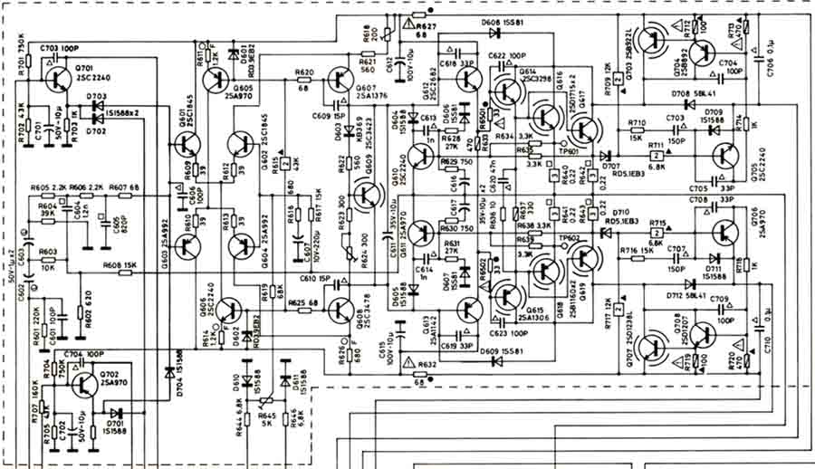

I'm troubleshooting a NAD 7250PE power amplifier. The output of the left channel has a -65 VDC offset and opens the protection relay RY801 via IC801. Does anyony have a suggestion on what component in this exotic amplifier might be the cause of the offset?
Here's what I have tried:
Removed R608 and RR617 to isolate 1st stage amp from last stage. Still has DC offset.
Traded Q619 with Q669 - problem stays with left channel.
Traded Q618 with Q668 - problem stays with left channel.
Any other areas to suggest?
Schematic attached for your consideration.
Thanks,
Thanks,
Found the problem!!! The culprit was R618 potentiometer (top middle), which the NAD service manual says is used to adjust for minimum distortion. It measured 1.5 kOhm instead of 200 Ohms. The little rivets had evidently lost their spring pressure. Now it is back to sounding great, and loud!

I have a NAD 7250PE amplifier with DC voltage swinging in the right channel output. There is some peaks of 25-30V, the protection relays goes off, then it returns to normal a few seconds later. I am searching for a leaking part, intermittent part, etc. and when i will solve it i will post on forum. Any help, please tell me!

Solved!
I found that the DC problem i have comes really from these little variable resistors, R618 for left and R668 for Right. Replacing with a new fixed the problem. I tried and you can just add a simple 100 ohm resistor to replace this control. Then adjust DC offset with R645, R695.
