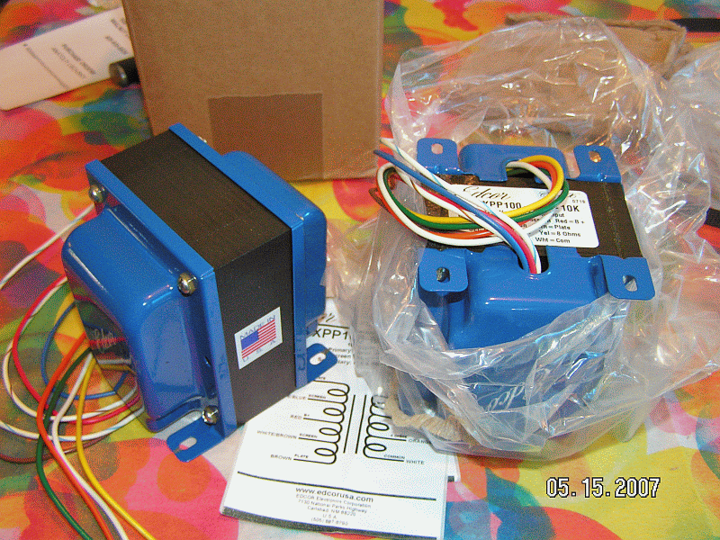

I've opened a thread about group buy of transformers:
http://www.diyaudio.com/forums/show...&threadid=98678
There will be 100 W transformers, 10K CT primary, 30 Hz-20 KHz, secondaries for 4,8,16 Ohm.
I've contacted several manufacturers and hope I'll find good source of OPTs under $70 each.
I'm designing this amps for home audio, sound reinforcement, studio monitoring. However, for guitar amps such trannies will be an overkill, but for bass guitars they will fit more than perfectly!

Wavebourn
Got output transformers:
soundbrigade
Oooooooooooooooo! Sooooooo Bloooooo!
What do you think of Edcore's transformers. I have a pair of 2,5K SE (CSXE) waiting for some kind of tubes and a apir of 8K PP (XPP) that are driven by a apir of 6AQ5 - sounds fine.
Wavebourn
quote:
I think I have to try them ASAP.
:smash:
PS: you have already tubes for 2.5K SE: triode strapped GU-50 :D
soundbrigade
Or twin GU50 strapped as pentodes?! More power ....:)
