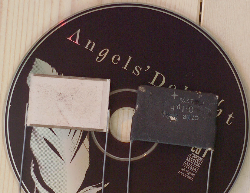

little OT:
I got 0,1µ silver mica but the coating looks like ashes and peels off easyly.
What is the best material to recoat them or is best sound naked ?
