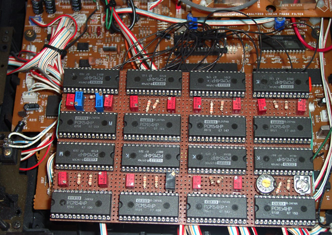

My new project:
A 16 bit DAC that uses one DAC chip per bit = 16 DACs per channel.
Chips are parallel data input / current output DACs BB PCM54.
They work as precision switchable current sources.
All 16 currents are summed up on the virtual ground of the I/V stage.
Every bit's output current is very fine adjustable, within the magnitude of 2 LSBs, having a low-ohm pot + resistor network between Iout and virtual ground.
Calibration will be done watching harmonics fade away on the analyzer.
If it works ok, there are options to calibrate without pots and resistors.

Shouldn't the error of even the MSB be less than one LSB? At least on a decent chip?
And isn't it likely you'll introduce glitch noise?
BrianL
Do you think that a bunch of pots and resistors that you trim (with what instrumentation?) will be better than the precision trimming of an individual DAC? I think not.
Surely it would be easier to buy and 18 or 20 or 22 or 24 bit DAC that has linearity to better than 16 bits.

Tolerance should be much tighter, about 1/50 LSB but it isn't.
That is why a few chips have adjustment for MSB + next 3 bits.

The precision trimming of an individual DAC is not that precise, thats why there are selection grades.
It is a simple game, all you must do is make disappear those vertical lines on the screen.
Nobody should believe that any 20bit chip is better compared to a 16 bit one.
The most expensive 18bit BB instrumentation DAC has 16bit accuracy from precise factory trim and needs user calibration with 4 pots to perhaps reach 18 bit.
Bernhard
I have built one channel and it works so far.
So far means the sound is distorted, harmonics -36dB @ FS which is about 2% ??? distortion.
What I had overlooked is that audio DACs have poor gain error of 2% :dead:
Now I will put in bigger pots and see how far the DAC can be calibrated.
Later the bit errors can be compensated to one or two LSBs by choosing different codes and the fine adjustment again with the pots.

- the poor gain error should not cause this 2% distortion. This is a linear distortion meaning that your output level in RMS terms would be off from the design value, but should be undistorted.
- even if the gain error would cause distortion, the fact that you have 16 DACs in parallel would average it out and the result should be much better.
I think there is another mechanism causing the high distortion. How sure are you that the input signal is distortion free?

So, Bernhard, not to discourage you, but what you seem to do is take 16 DACs, use only one out of 16 current switches from each.
Then, because you lose the inherent advantage of IC matching, you need to individually adjust each current switch to try to come close to the matching you would have in a single 16 bit DAC.
Where is the advantage?

That I can do it.
Integrated DAC usually have only one pot for the MSB.

... but at any rate the integrated DAC is way better than anything you can come up with. Have you thought about a tracking temp compensation for your battery of pots, to mention just one issue?

In the end the adjustment range of the pots will be very tight, tighter than MSB adjustments of integrated DACs.
If necessary, I will build a master-slave configuration where the slaves compensate the gain errors of the masters to below 1 or 2 LSBs.
All lab instruments have calibration, why not DACs ?

That is the point. The pots can not be integrated into the DAC.
If the total adjustment range is only 1 LSB, how much can the drift be ?
The big 18 bit BB DAC729 also uses 4 optional pots to reach full resolution, which is not possible in chip production.
For temperature tracking I could mount the DACs on a common heatsink and put them in a closed chamber.

It is much better now with 1k multiturn pots.
Even -60dB is easy to adjust and sounds very clean.
I will post some pictures later.
Bernhard
Calibration is real tricky but now all distortion artefacts are gone, -60dB sounds clean except some background pink noise.
