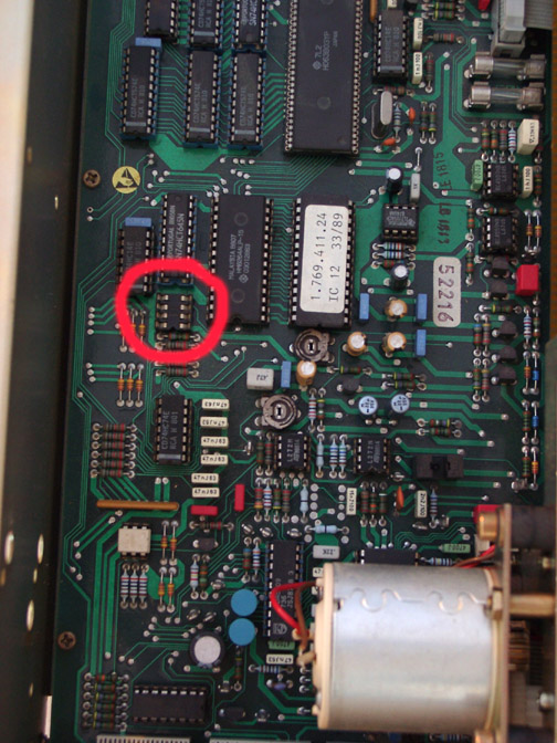

I got a dead A727 that had a shorted 10000µ/16V Frako cap.
After replacement it still does not read disc.
Questions :
I measure -15V but only +12,2V for op amp supply. Is that right ?
On the prozessor / servo board there is an empty socket like for 8-pin op amp from the two L272 and the two pots to the upper left.
Is that ok or something missing here ?
Bernhard
Netlist
The manual says -15 and +12V.
As for the IC, the picture in the manual shows an equal empty space.
/Hugo
Bernhard
Thanks, sometimes when I press play, the player goes off completely.
Recently it was on for longer time and it played but with strong artefacts.
When I touched the upper pot with screwdriver to adjust, it blew one of the 1,25A fuses on the transformer/CDM1.
Going out to buy fuses :dead:
I love Studer / Revox , always multiple errors :D
Netlist
quote:
And a pot...:)
/Hugo
Bernhard
quote:
Originally posted by Netlist
And a pot...:)
/Hugo
No, but it really blows the fuse when I turn on of those two pots.
That wasn't the case first.
Bernhard
Okay, works.
One of the TDA servo chips had bad contact in the low cost IC socket.
