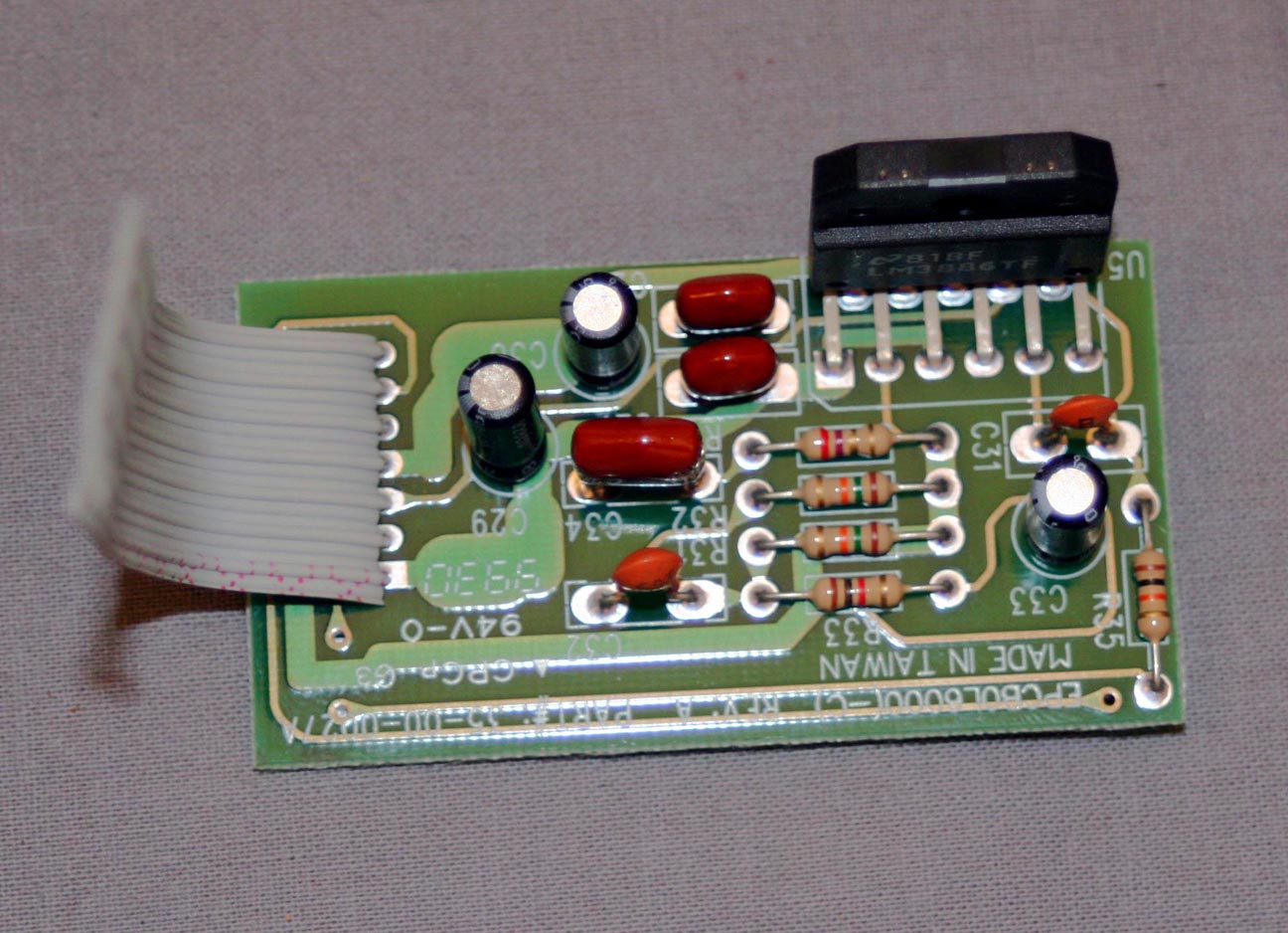

I bought the following LM3886 Board from APEXjr ...has 7 connectors...from tracing the circuit, I have determined the following board pinouts (no documentation exists)
Pic here
http://apexjr.com/images/LM3886Board.jpg
ANYONE FAMILIAR WITH THIS BOARD?
From top of pic
Wire 1: + Speaker Output
Wire 2: Vin- (line in+)
Wire 3: GRND
Wire 4: Vsupply -
Wire 5: Mute
Wire 6: Vin+ (Line in -)
Wire 7: Vsupply+
With mute disconnected, no sound at all (muted - duh). With Mute connected to Vsupply- with 34Kohm resitor, nothing but hum...
I have +/- 19.5 Volts and I am quite sure the Power Supply is good to go. +/- volt rails are correctly connected to the proper leads on board
The entire setup is on a wooden board and have the negative speaker output, transformer ground, connected to the GND (wire 3)...no chassis or chassis grounded.
Chip is insulated type, so no issues with heatsink grounding.
Driving me crazy!!
ANY HELP OUT THERE??
john65b
Looks like all I needed to do was connect wires 2 and 3 and violla..duh.
Don't know how I missed that...
john65b
Actually, put in the Mute resistor between Mute wire to pin 8 and V-Supply rail, and mute capacitor to signal star (observe corrrect polarity - + on ground)
And then separate Power ground star from Signal ground star, the reattach the two ground stars with a wire to complete the grounding circuit.
Funny how everything always works when you folow the schematic.

Sounds great. I need to fianlize the wiring, as they are hanging all over the place, and need to separate the two ground stars, and then reconnect with single wire (from what I've read, helps sound).
I also have not put the correct Mute resistor in (22k vs 30k) per the LM3886 spreadsheet, nor have I put the mute cap to ground in either. This should be the reason I still get a pop when I turn on the power.
First thing I would mod is the Feedback resistor. 15k ohm seems low, and according to spreadsheet, reduces gain considerably. Spec says 20 - 22k ohm.
