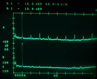

upper graph is Philips CD880 , lower graph is Denon DCD1500II with PCM56 and accurate distortion adjustment.

As always this is with -60dB signal. TDA is clearly distorted while PCM is much better and distortion is below noise floor.
It simply means that in low level music passages you will hear the difference.
Both standard implementation as in the CDP.
The difference between the chips is that PCM allows for adjustment and TDA does not.
This adjustment makes a big big difference.
The PCM might look worse than the TDA when unadjusted.
Also some ( even unadjusted ) PCMs are better than all TDAs I have seen.
Strangely some PCMs already measure very good in a circuit without adjustment pot, while others perform even better with adjustment.
It is very very difficult to do the adjustment with a standard pot, 10turn pots are necessary.
Also there is temperature drift, best is to wait 12 hours before doing it.

as a matter of fact, you did not test the performances of the DAC chips alone, but of the two chains oversampling(if any)/DAC chip/I-V converter/analog filter...
What about the jitter in the two players?
Did you use exactly THE SAME CD (I mean, swapping it from one player to another)?
Don' t get me wrong, I' m not saying that there' s no differences between the two chips, I just mean that the differences you measured are probably not due to the DAC chips only.

I have tested all combinations of TDA /B & SAA A/B chips with and without os in different players like Philips CD304mkII, CD880, CD960 and PCM56 /J/K in Denon DCD1500mkII, DCD3300 and a Kenwood.
Always for the PCMs a good chip was a good chip in every player and achievable results with PCM are clearly better than TDA .
CD was always the same.

-60dB 1kHz sine from CD, amplified with OP27 after DAC.
Analyzer bandwith set to 10 kHz, picture shows 1kHz & K2-K9.
Noise floor on all players around -64dB ( 1kHz signal set to 0 dB on analyzer )
Harmonics around -55dB for TDA and around noise floor for PCM.
Vertical scale 10dB / div.
Quoted value of the datasheets for BB PCM chips is always without adjustment. And chips are very different. Some are very good, some very bad, independent of J or K markings and I am afraid this is because of parameter chancges due to aging.
A K-chip may turn into **** after years of use and vice versa.

the BB chip is quoted to have -35dB THD at -60db out/1KHz.. You say you can adjust that to -64dB?? How the hell is that possible..? How can you adjust a 16 bit DAC from -35dB to -64 dB THD?
The TDA5141 has a quoted THD of (around) -40dB, and is among the best ever made.. Yet you measure -55dB THD?? That surely isn't possible??
Offcourse I could be wrong.. but maybe there slibbed a error in your measurement methods?
Don't wanna be hard on you m8, but your results a extraordinairy, i'm just very interested
