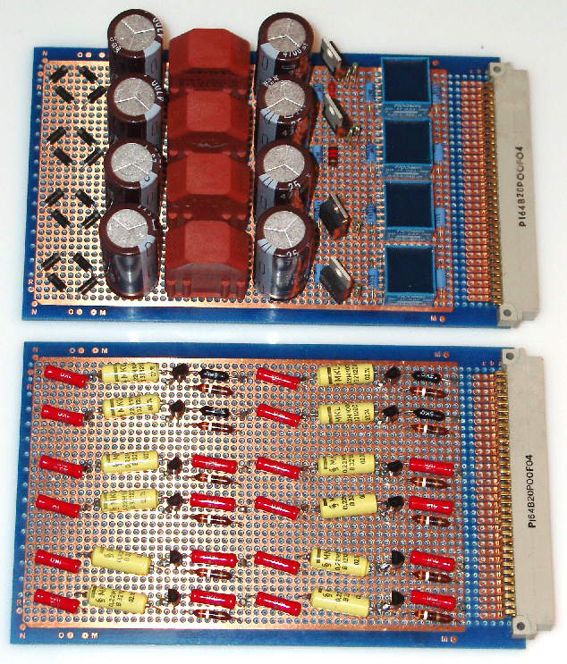

Bernhard
4 pre-regulators for 5V -5V -15V for TDA1541 and 12,6V for tube heaters.
12 TL431 regulators for TDA1541.
