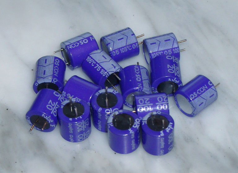

Hi ,
what is special about this caps ? Sound good ?
I have 220/10, what can I do with them ?
Has anybody ever tried Siemens MKL ?
Greetings, Bernhard

They're special because they are a little closer to the "perfect capacitor" than most other electrolytics.
Whether they sound good or bad (like any other component) depends on how you use them.
The value and voltage makes them perfect for cathode bypass (decoupling) in many small signal valve stages......time for a change?;)

Although I am very fond of OSCON in digital gear I am surprised that they are recommended in tube amps. My experience is that they don't sound optimal in the analog signal path. In the digital part of cdplayers and for the supply of low jitter oscillators they are the right cap at the right place. I recall using them once for decoupling an opamp in the output stage. Deteriorated the sound, very thin bass. It took me some time to find out that it were the OSCONs ( 15 uF 25V ). I gave them the time to settle but couldn't get good results.
SXE is very good. Mmm, nearly miswrote that quote :D Long life and low ESR and good sounding. I forgot about LXF, couldn't obtain them easily as well so I used SXE instead. OSCON is better though.
Please google for datasheets on OSCON. You'll like what you'll read...

In my experience OSCON's are great for digital circuit decoupling. However a bit sharp sounding for decoupling analog stages. Nothing i know beats Black Gate in that area.
LXF - SXE are you talking Nippon Chemicon's?
We used a lot of these in the 90's where analythical was good, and micro details analysis was better. (At any cost .. specially musicality). Nowadays though, other sound types and other capacitors are preferred.

The OSCONs that I have are purple and say 105°, but have magnetic leads, so nothing for the signal path, but for digital decoupling should be very good because 0,4 Ohm @ 100kHz.
Found a website that says @1Mhz and 15MHz better ripple rejection than BG :xeye:
What about Rubycon GXF 10000µF/10V ?
The thing is I plan to build low voltage rail classA amp and 10V caps are perfect.
I wonder if the magnetic leads of the OSCONS do harm if they are in the analog psu.
Also TO3 Fets are magnetic and a lot :bigeyes:
