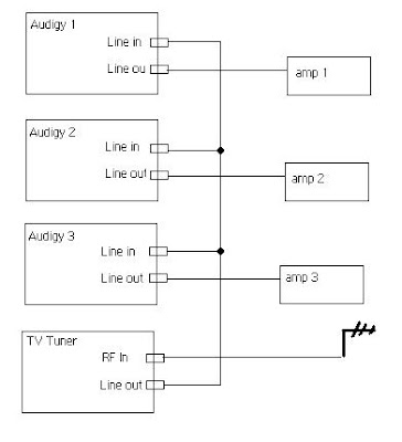

Probably a silly question, and 'just go buy a audio splitter'...
I have 1 line out (fm tuner)
and 3 line in's Audigy ZS's
will it affect signal if I to a 3 way split cable...
or am I better of doing a diy 3 x opa2134 splitter of some sorts.

stevodude
That the problem I can't get any details of specs.
What I am meaning is.. hang on I'll do a lil diagram...
The audigy cards are the sb0350, Audigy 2 ZS PCI.
Found link to audigy 2 zs: support.creative.com/audigy2zs
support.creative.com/audigy2zs_spec_guide
nothing on line-in impedance etc...

I suspect that you should be able to just run a splitter from the output of the tuner to the input of all three cards, and not have a problem, but it's hard to say without knowing the input impedance of the sound cards and the output impedance of the tuner. If you build a buffer amp system, it can't hurt, except for a minor hit in the sonics department.
Peace,
Dave
stevodude
so I did some googling, and the nearest I found was a range of 10k - 22kohm line-in impedance of some sound blaster cards.
Also that a typical line-out pc card is normally 1Kohm...
So my question would be:
Would I blow something up, sound card, or tv tuner line-out?
If not I'll give it a try.

stevodude
can you route audio line in on one card to output on another card? maybe this can be done with linux/pulseaudio, but would be way too difficult for me.
reason for the above, is if I am in a different 'zone' ie balcony or backyard, then I want to turn radio on the location I am.
I have made the 3way Y cable, and can report that it works fine.
I have wireless and a simple web control to change channel, turn radio on/off(line in) for all the cards/zones. I also have 3 instances of MPD running on the server (1 for each zone), so i can listen to my flac files anywhere, and control radio through my 802.11 wifi/pda/phone device.
