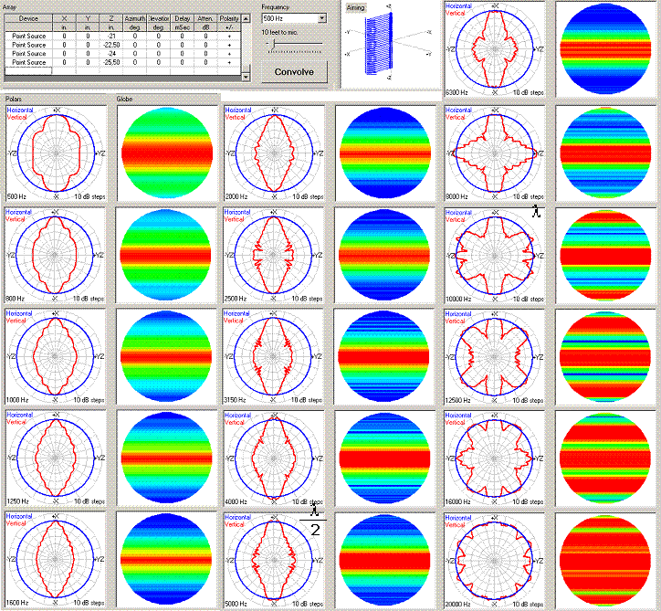

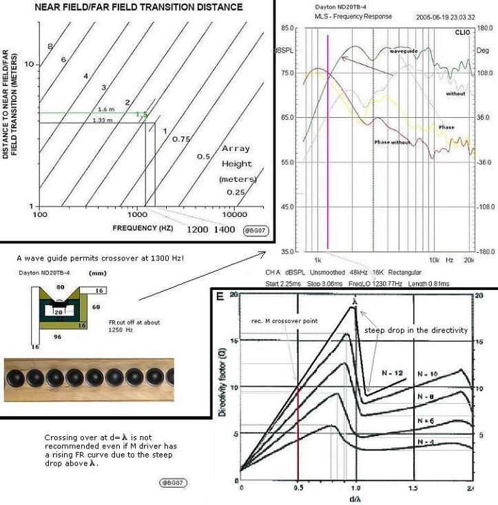

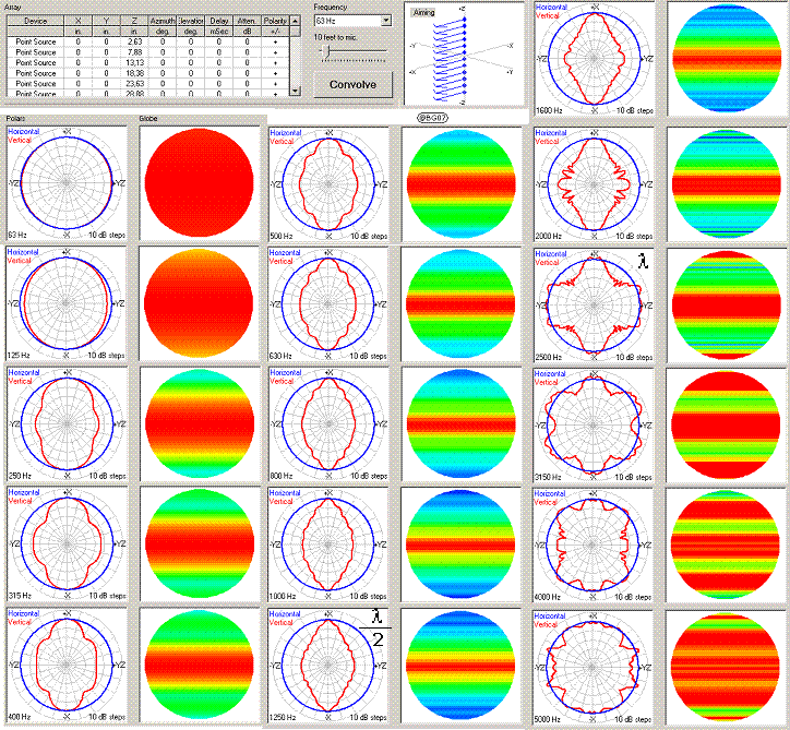

zobsky,
0.3 Ohm difference is negligible difference and your wiring scheme is ok whatever if you don’t want to power taper.
Where will you place your arrays, close to the corners of the wall or placed away at a distance and will the baffles point perpendicular towards you at an angle or not?
Your arrays are good up to 10’ or about 3 m near field listening distance.
See the near/far field transition (low) frequencies capability in pic. # 1 for both the M-array (cut-off at 208 Hz) and T-array (cut off at 250 Hz) are averaged to about beginning at1300 Hz.
Only if your M arrays are extending to about 70% of the room height the transition frequency for the M drivers will lower to a cut-off at about 70 Hz.
Use a frequency about 1300 Hz / low order LP filter and the c-c lamda/2 criteria for the M’s when aiming for quality arrays.
If using the double frequency for a crossover, you are at lambda and must increase the filter order to defeat the polar perpendicular blooming, which starts to be sever at this (lambda) corresponding frequency. See pic #1.
When designing a filter my rec. are for the T drivers to choose a high pass filter with the lowest resulting acoustic order as possible if you want to design for quality transient response and equal or higher order low pass filters for the M’s if it’s necessary to aim the dispersion lobes horizontally and always use lamda/2 or even lower frequencies for a quality array.
See pic # 2 and # 3 where the on axis performance for your arrays are simulated using point sources i.e. where your drivers have a flat on axis FR this will exactly correspond to the plots.
The polar off axis must be degraded with the real off axis levels (slopes) in order for a true polar off axis curve and obviously the width of the on axis response for a real driver cant be better than what the plots shows.
I rec. to use for T array the Dayton ND20FB or ND16FA together with a simple wave-guide. See pic # 1.
