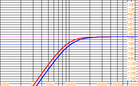

The following is a WinISD simulation of the two sets of numbers, stated and measured, for the Audax HM100Z0. this is for a sealed box of 4 liters.
The stated numbers are in red.
The measured numbers are in blue.
I would call this pretty good agreement with the stated specs once this thing is put into a box. Calling the F3 of the measured spec 103 Hz, I would say that the stated spec gives an F3 less than .2 of an octave lower than the measured spec.
Put another way, where the stated specs are 3 dB down, (90 Hz), the measured specs are 4.5 dB down.
For good makes like Audax and Peerless, the measured and stated specs do tend to work out this way. This is good for ported and sealed boxes. For transmission lines, maybe not so good.

And just to further illustrate, here is Francois' Peerless 850102 in simulations of both published and measured specs. This is for a sealed box of 2.5 liters
The published specs are in red.
The measured specs are in blue.
At 121 Hz, where the published specs it should be 3 dB down, it is actually 4.5 dB down. This is not even taking into account a possible SPL shift with the difference in numbers.
This squares with my experience with Peerless too. It also agrees with the experience of Madisound, who measures the drivers when they come in. The Peerless model I ordered from them had different specs, but similar performance to published specs when placed in a box. In that case, it was the opposite direction-the speaker had lower fs, but higher Vas. But it all worked out when put into the box. (Actually, optimum vent tuning would shifted slightly with the new numbers-but even then, the old vent tuning would have worked OK.)
In a better world, the published specs would be a lot closer to the actual specs. But in this world, I guess we can live with the thing just working out reasonably all right in the end.
