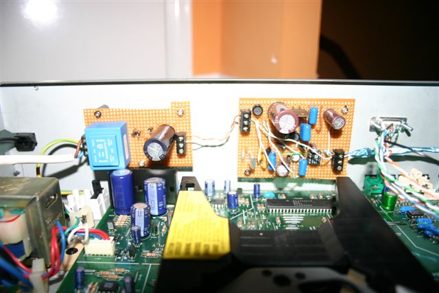

Firstly, I built a variant of a Kwak clock (its single regulated, amongst other minor changes, and probably no improvement on the original v7), which I powered with a seperate PSU, and mounted all this on the back panel.

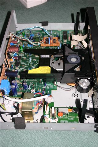

The new clock signal is fed directly to the decoder chip, rather than to the DAC and then fed through, and the DAC and digital filter circuits, along with the IV conversion and headphone amplifier etc have had the power completely removed.
So, the only things alive on the board are the CPU, the display, the CDM and all its servo circuitry and the decoder.
Beyond that, I haven't actually done any mods as such to the board. I hope to improve the regulation, but its not a priority. I'm sure it would be better if this was done (based on my experiences with modding the '63) but thankfully, the power rails aren't being shared with too much.

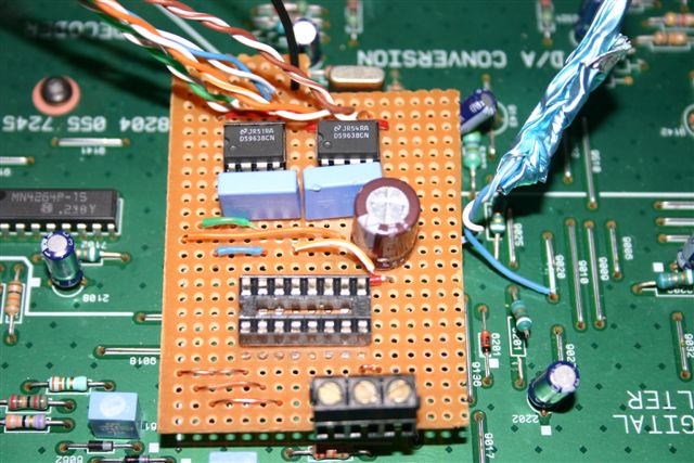

To complete the 'design', I added a differential output for the I2S signals. I did this using two NatSemi DS9638 (Dual differential Line Driver) to convert the TTL signals into basically RS-423. I built a plug in board that plugs into a DIL socket where the I2S-SPDIF converter chip normally sits (I can't remember its name at the moment). For the pins of the plug in board I wasted a few TO220 packaged transistors (nothing like DIY LOL) and managed to make a piggy back board, that sniffed off I2S, powered the RS423 chips, and allowed the SPDIF encoder to remain in circuit (well, would of if it wanted to continue working! - nevermind, I don't need it any more).

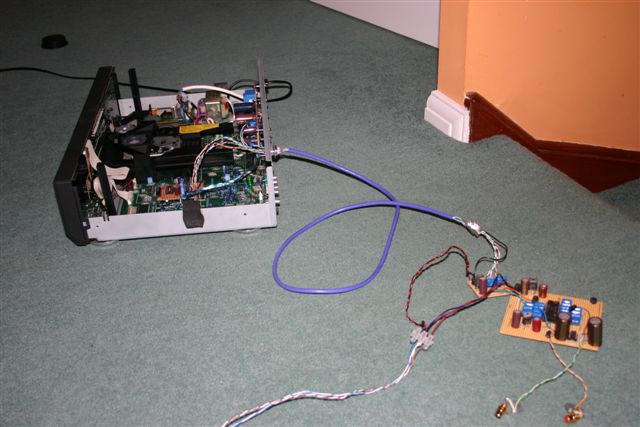

Anyway, this daughter board drove 8 wires, in 4 CAT5 twisted pairs to a 9 pin D type socket on the rear of the transport. Feeding BCLK, DATA, WS and also the clock signal (which I was hoping to use for reclocking at the DAC, but haven't, and might well disconnect it).

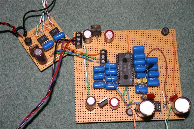

At the other end, I had the complimentary DS9637 receivers (make sure the two inputs per receiver have a 100 ohm resisitor across them or it doesn't work {I learnt that the hard way 😉} - its not too clear in the datasheet), feeding my first, still experimental DAC.
Using a metre of cable, I works fine, and I can tell no difference between a metre and 3 inches of cable. I think I have about 5 metres of CAT5 in the house, and might try and see what its like with a cable run of that length, it should be fine according to the datasheet, and I don't need it that long, so it might happen maybe one day.

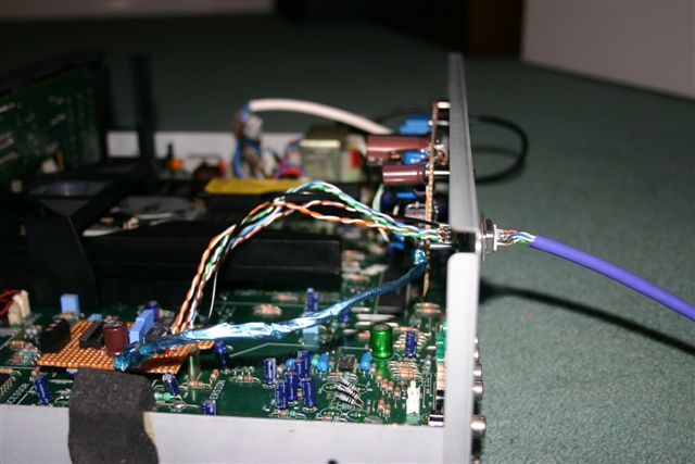

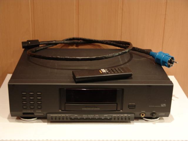

Firstly, here's an overview of the modded CD940...

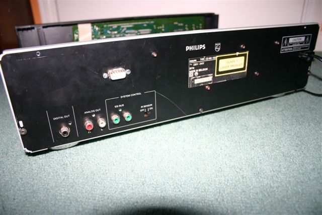

The Kwak Clock 7 is a fairly straightforward thing to make.
You should be able to search for the schematics in the forum.
I've made three, and if you take your time, it should be okay.
As you can see in this thread, there's plenty of room on the rear panel to mount it 😉
