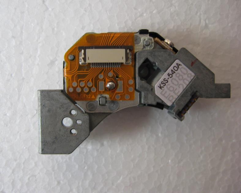

Like the laser pickup KSS-190A, KSS-270A, KSS-271A, KSS-272A, KSS-273A/B, KSS-280A, KSS-281A...and the CDM1 pro, mk2, and other early CDM series of laser is hard to find now, since it is out of production for a long while.
if you are a professional DIY, you can try to change the laser tube in it, may be it can be help you
