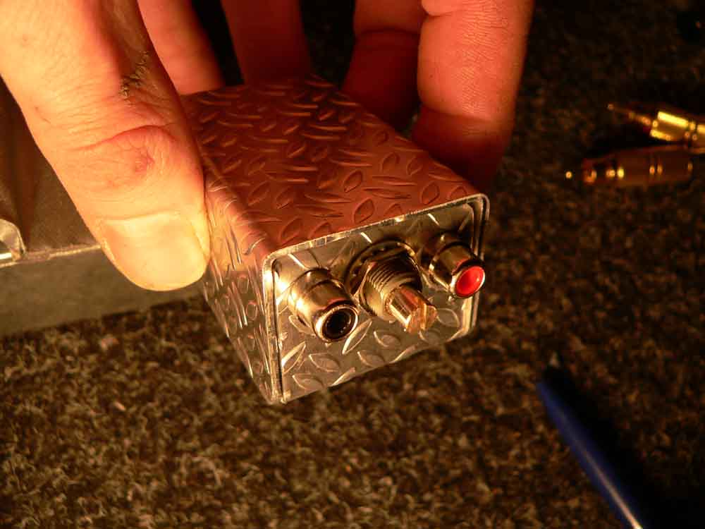

Perhaps I should clear a bit on my methods and equipment. I made another couple of PVC enclosures, this material is not ideal for getting the best results. But the tests are based upon comparison between drivers, and the enclosures I used are about the same (only tweaked the stuffing a bit...). All were tested on AMP32 and AMP9 from http://www.41hz.com on SMPS supply. All drivers were optimized by PLXXO notch filters and run through 1:2/1:4 (switcheable) audio transformers to boost up the voltage a bit from my MP3, MD and CD portable players (and compensate for the loss by the filters). The signal run through both the transformer and filter
has a bit more gain and has much better bass and highs. The transformer is mainly responsible for the bass enhancement, the filter does both (and takes away that mid-high range edge that most fullrange drivers suffer from)... I made two filters, both are adjustable with a potmeter to simply go from "SHOOOOUUUT" to "BOOM~boom~PSS~pss~PSS...:) but one even has switches for two different cap values and three different resistor values added :cool: All in 'mini' aluminum diamond plate chassis (as usual ;)

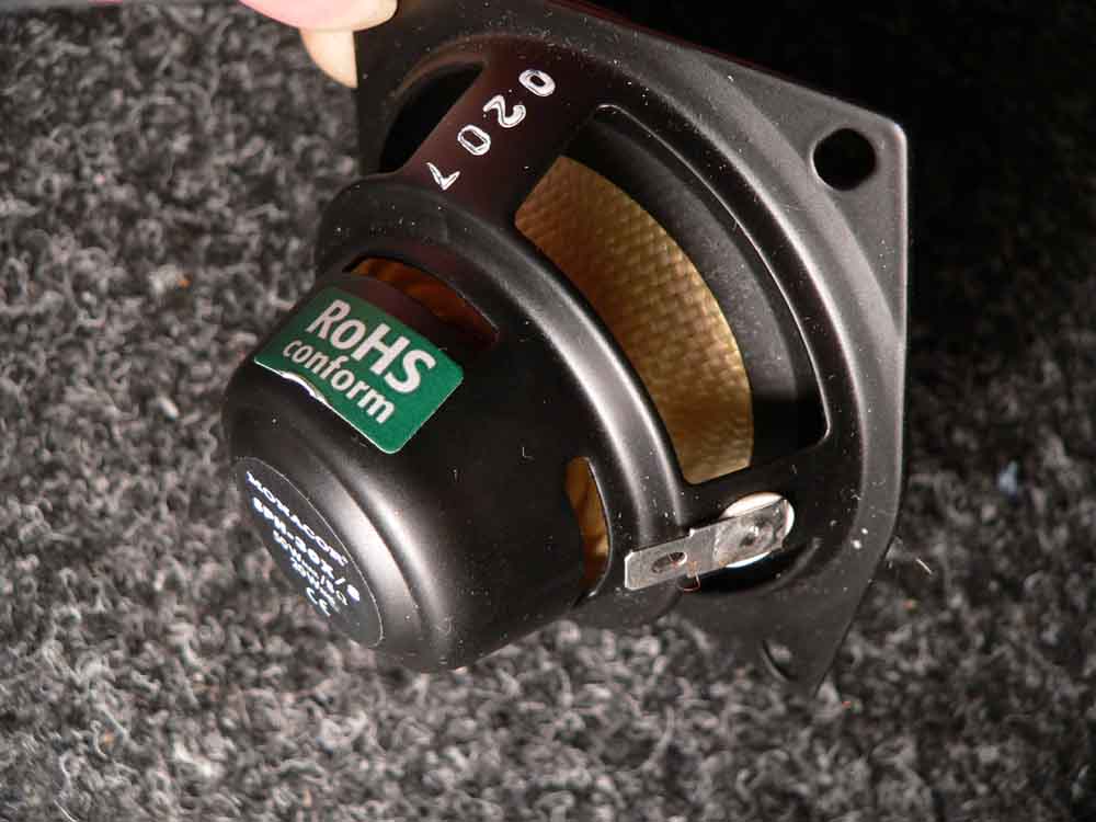

Next up (and the latest I tested) Monacor SPH-30X:
http://www.bmm-electronics.nl/Product.asp?Product_ID=5573
The extra you pay for this driver is payed back in equal amounts of soundquality. The bass is phenomenal (for such a small driver...), it's light (because it has a neodymium magnet) and magnetically shielded, made from very durable materials, shows very litlle distortion, handles quite a lot of power and the efficiency is GREAT! Not even speaking of the very fine high frequency resolution and the good staging that goes with that. Absolutely the winner! :cheers: A lot seems to do with the good construction of the driver, like the rubber edge is really thin and flexible which saves energy I think. The voice coil windings can be seen through openings behind the spider, this driver is very well ventilated. Also the basket is from one piece of steel all around the magnet, large and reliable connections are riveted to it 180 degrees apart with nice looking litz wires going to the voice coil. It all has a slight 'Morel' feeling to it, they also use steel baskets the same way. And last, but not unimportant to me, it looks very good IMHO (no glued wires visible around the dustcap...) An a+ in my book!

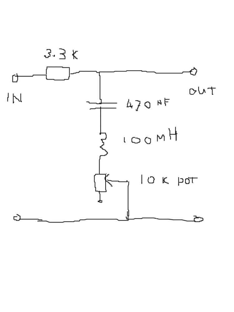

Oh yes, if you want to know more theory I used to make the notchfilter:
http://www.audioasylum.com/forums/hug/messages/120394.html
The coils I wound myself (15 minutes per coil with a fixed electrical drill from a large spool of enameled ofc copperwire I have, cores are made from a stack of six plates of steel from an E-I core transformer).
On the Monacor I use a 3K resistor from the source and paralleled a series network of a 154nF capacitor followed by a 97mH coil and a 10K potmeter to ground, don't know if I've done everything right here, but I tweaked it a lot and got to a nice setup for each different driver IMO.
The FRS8 sounded nicer with a 5K resistor from the source, 330nF cap, 110mH coil and also a 10K pot.

Look how cute, but there's a beast hiding in there...:clown:

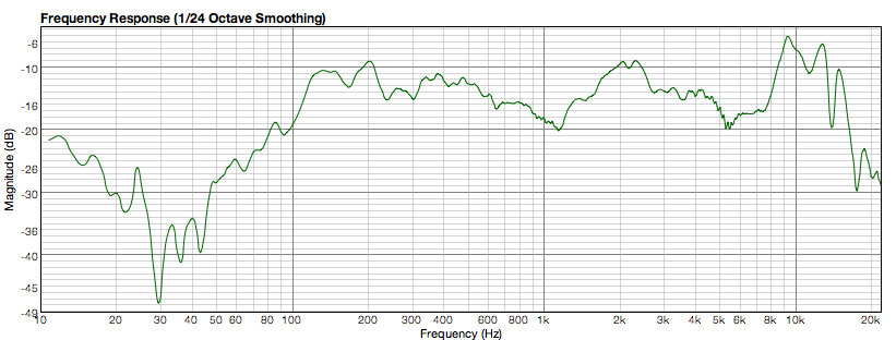

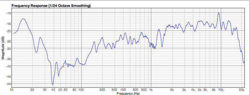

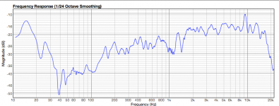

Interestingly enough, these FR8 and SPH30X exhibit the same single sine wave pulse looking response around 3kHz and have a peak in the response around 10kHz. The FRS8 on the other hand has a much smoother response and no peaking at 10kHz. The FR8 and SPH30X are also more sensitive than the FRS8. Judging just from the frequency response the FRS8 should have been the winner. You mentioned that you thought the FRS8 "definitely needs a tweeter" indictaing that, like many, you prefer a rising treble response OR have less hearing sensitivity to higher frequencies. I know I can't hear over 17kHz...
Bwrx: The FRS-8 should indeed show a nicely flat response, but my experience is they sound quite matte... I confirmed this more or less with a portable spectrum analizer borrowed from a collegue. Or maybe my ears are going down, maybe I should have them tested first :D
The other drivers (FR8 and SPH30X) indeed show some harshness without the filter. The FR-8 is incurable in this IME, I tried many filter configurations.
The SPH-30X on the other hand keeps a high dose of finesse and detail richness in the high frequency range. Though without the filter it sounds overbright and a bit coarse in the higher mids...

Next thing I was thinking about is to create a subsonic filter to protect the small drivers a bit from the bass peaks...So I'm thinking notch@10Khz and highpass@80hz...
Any ideas would be very welcome...:worship:

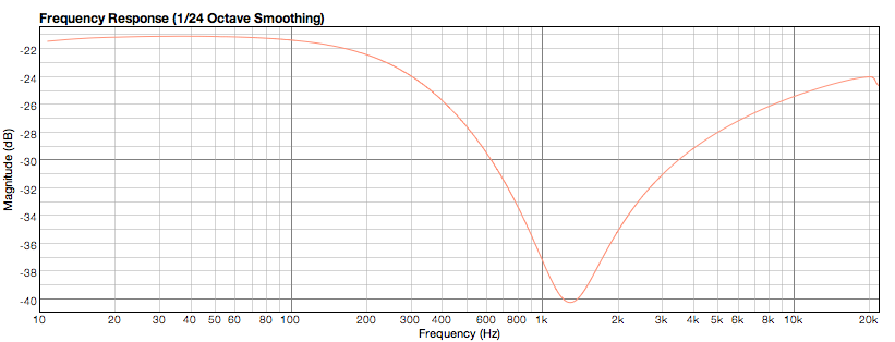

Did some measurements on the filter and the combination with Monacor SPH-30X...
I immediately changed some components to raise the frequency on which it filters (the dip is now @ 2.2Khz, still quite wide range...)
Here's what I had initially created, and sounds quite nice...
It was measured with the potmeter in max. filter setting...
In real life it's a big plus IMO. The highs don't sound harsh at all, rather delicate and detailed. Note the measurements were done pretty close-up, from larger (listening) distance the higher frequencies normally stay more behind. At least it gives a tonal balance that makes you suspect a tweeter is used.

My posting these measurement is merely to give a slight insight in the system, intended for those (experts, gurus) who also know the difference. Not to draw conclusions out of, or claiming I did the right thing. I can think of a million things to get that line straight in the FR graph, but it doesn't have to sound better, I agree...
