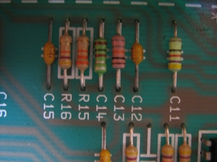

I was trying to fix my Valvestate 8080 too. Just bought it pretty used.
The reverb is always ON and the footswitch doesn't do anything. In fact this is a minor detail since I can turn the pot to 0 and just shut it down... Anyway, the channel footswitch button is working ok.
I gave up on the reverb problem when I found that lots of capacitors on schematics where actually resistors on the PCB! It doesn't seems to be a mod done by the previous owner... it seems to be industrial soldering.
Does any know if in any hardware version, capacitors C1, C2, C25, C30, C23, etc. where replaced by resistors?

What color are the "capacitors"? Those are most likely capacitors, they look like resistors but just caps in a resistor type package. The color read similar to resistors.

Maybe caps in a resistor type package? 😕
Take a look on a picture that I took from caps (?) C11, C13 and C14. Are they really caps? In this case, what's the name of the package?
Good look with your 8080. Getting the correct parts is the most difficult step! Once you get them, just be cool and everything will go right! 🙂
Took one of the strange capacitors just to measure resistance. They really are capacitors! Damn... trick one!
What is the name of this capacitor package? Color coded, by the way!
