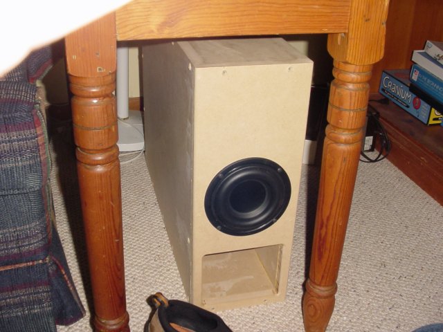

It was me that designed that sub for the W5. That isn't a classical transmission line by any means. Instead, it's a relatively newer design called a Decoupled Antiresonant Line, or Daline. There's virtually no published theory except for rules of thumb which describe an unstuffed quarter-wave line with a 'decoupling chamber' between the driver and the line, whose volume is equal to a typical sealed enclosure for that driver. Drivers with low Qts work best. The recommended tuning of the line is around 0.707Fs. The results I've achieved from my Daline subwoofer are impressive, especially in my open-plan house, though I think I could have still benefited from using MJK's Mathcad worksheets to optimize the enclosure. I get the feeling that woofer excursion isn't controlled as well as it could be in my Daline, so that's something that could be optimized using the MJK worksheets.
If you need an enclosure that can provide enthusiastic resonant augmentation to your woofer, definitely take the Daline concept for a spin -- use the rules of thumb that I detailed above as a starting point.

Taterworks, interesting concept. I've never heard of a DAline before, I'll have to look into it. The enclosure is pretty large though, my 8" Dayton DVC enclosure is ~45L. I was hoping for a tall, narrow baffle, folded tapered line enclosure of fairly low volume. I don't have Martin's sheets yet, so hadn't had a chance to run any calcs.
I'll probalby lay down the $25 to get a copy of his latest sheets and toy around with them, but not until after I move into my new place this weekend.
Oh yes, and apologies to gychang, I seemed to have completely derailed the thread from his original line of inquiry (although what I have in mind could be pretty much on par with what he asked for).
I feel that a real strength of my design is its completely endfiring design, where it can be tucked behind something like a sofa or an entertainment center, and there will be no worry of blocking a side-firing woofer. The Daline generates plenty of output, and there's definitely an output-for-compactness tradeoff here, but I think the Daline design gives you plenty of options for the form factor of your box, while if you used a larger driver, you'd simply need to make a big rectangular box. A slim, endfiring design would be much more difficult without the Daline's ability to produce more output from small bass drivers. I think that with your transmission line design, you'll be throwing away some of the back wave of the driver, which can be used to do useful work instead. This is because the line of a transmission line is stuffed, while the line of a daline is unstuffed (though the main chamber may be tweaked with stuffing).
All valid points Taterworks. I will definately have to give in to the temptation of building a daline. I'll probably build a daline and a tapered TL for comparison and experience sake. It's not like the W5 drivers are all that expensive, even at regular price.

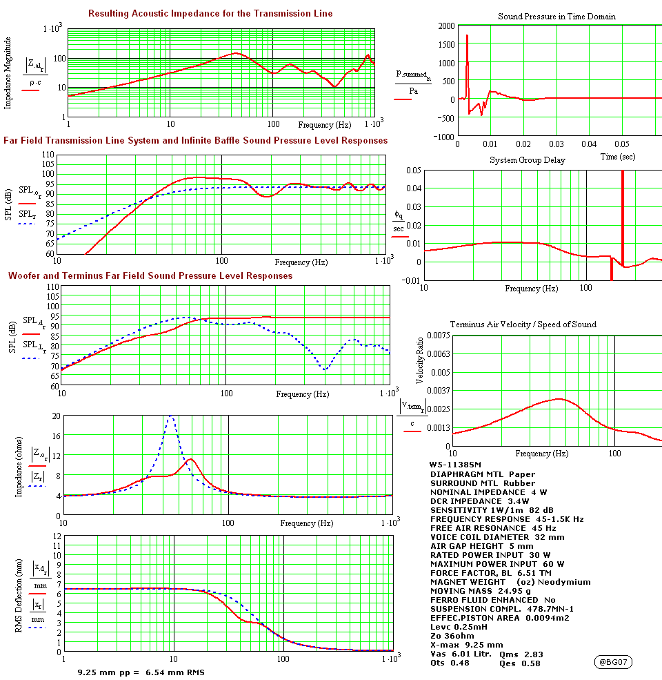

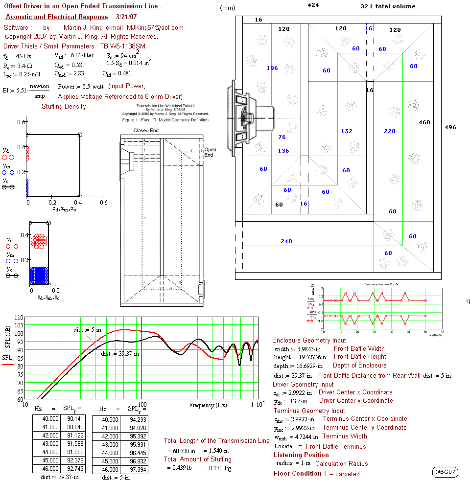

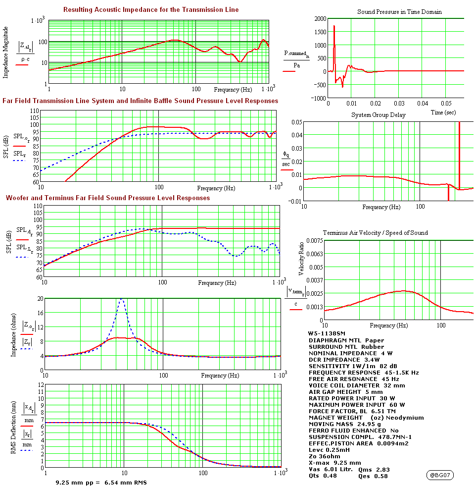

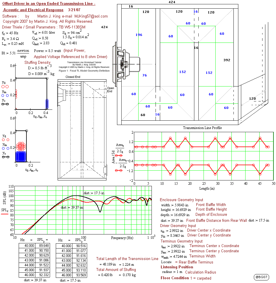

No need for an especially elaborate theory, its already completely covered by any ported theory that includes the acoustics of a folded line like MJK: s quarter wave papers does and simulation programs do as well.
The Daline generates plenty of output, and there's definitely an output-for-compactness tradeoff here…

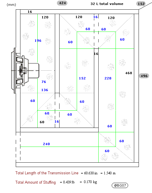

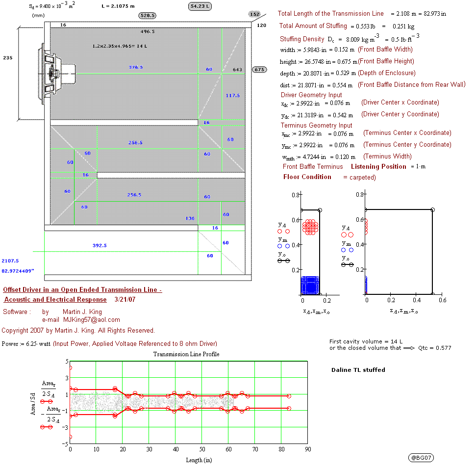

In the perspective of Thiele/Small volume/efficiency/cut-off relation: ” nO = Kn x Vb^3 x F3” Its easy to demonstrate that a folded compact ML-TL is the real winner over a Daline (a folding takes volume but many more means more internal volume loss too) because it uses a larger internal volume for the same cabinet gross dimensions and a comparatively smaller port to achieve a lower cut-off frequency, a wider bandwidth, a smoother FR, a higher LF sensitivity, a better transient response and a lower group delay.
I'll probably build a daline and a tapered TL for comparison...
Yes why not, and post your findings here at the DIY forum.
More simulations also covering the Daline approach, See pictures 1(7)-7(7).
