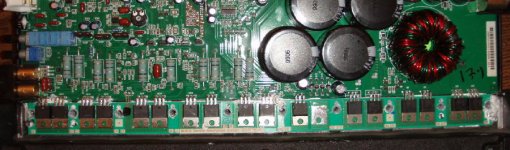

I have a fosgate power 1100a2 amp that has dc voltage in one channel .
The left channel works fine, the right channel has 52 volts dc output.
one of the subs seized a coil and took the amp with it.
Would replacing the outputs fix it or is more wrong than I know about?

It's rare to have only the outputs fail. Generally it does more damage.
Does it have any shorted output transistors (it probably does but this needs to be confirmed)?
Have any of the emitter resistors opened (significantly higher than 0.1 ohms)?
Can you post at least one reasonably good photo of the channel that's failed?
It has 2 shorted irf 640 and 3 irf9640
Emitter resistors check out ok.
here are some pics
Have you pulled them to determine if they were shorted?
In the board, they are in parallel and should look like they're all shorted. If you would have checked from the gate to the other legs, then you could see a difference due to the resistance of the gate resistors.
If you still have a few in good condition, you could clip the defective ones and see if there's any DC offset. If not, there may be no other damage.
As a side note, this amp is probably the same as the 500.2 that I recently repaired. I'm not sure what this topology is but don't look for normal audio on the outputs. The audio is riding on the rails. The transistors drive windings on the power transformer and the speaker output is taken 'from the power transformer'.
These are much less common than the normal amps and don't seem to cause as much damage as the common design.
When you pull the outputs, you'll need to double-check the emitter resistors and the gate resistors.

Double-check the emitter resistors. Most meters don't read accurately at low values and you have to be be very careful to make sure you get an accurate reading. For most of my meters, you have to hold the probes on the resistor for a few seconds to let it stabilize. In an amp like this where the transistors will be run hard, it's important that the emitter resistors are very closely matched.
Remember to power up the amp via a 10 amp fuse when you bring it up for the first time. If it blows a 10, you can try a 15 but nothing larger.

With the outputs out of the circuit, the gate and emitter resistors are open on one end. The only components that may be able to influence the readings are the protection circuit resistors in parallel with the emitters but their value is generally several hundered times higher than the value of the emitters so they don't have much of an effect.
all 10 outputs are off the board
2 bad outputs
with outputs off board emitter resistors read 0.0 ohms , all 10 of them
gate resistors read
1. 100 ohm
2. 100 ohm
3. 100 ohm
4. 100 ohm
5. 100 ohm
6. 112.3 ohm
7. 100 ohm
8. 104.5 ohm
9. 100 ohm
10. 104.7 ohm
Of the 3 that are over 100 ohms, only one is technically out of tolerance but I'd change all 3.
If you have the A06s and A56s, you may as well replace them. I don't like changing parts without a good reason but this amp takes quite a bit of time to repair. There's no reason to take a chance on blowing the outputs for $0.40 worth of parts.
Just for fun... Check the ones you pull to see if any failed. Check them carefully to see if any are leaking.
I'll assume that the 100 series parts were actually 200 series parts 217...
What about 216?
What is the voltage on them? If all of the same part number have the same exact voltage, you only need to post two voltages.
Are any shorted? Sometimes a defective driver component can cause new FETs to fail. Other times, they can be damaged when they're being soldered to the insulators.
