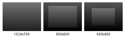

Pics of QA-2500/TV-4000 Problem
Here's an illustration of what I'm observing from the TV-4000's 3 different output resolutions on my QA-2500. For lack of any better information, I think I'm going to try the ViewSonic VB50HRTV and ViewSonic NextVision 5 with the QA-2500 and see if I get any more promising results.
