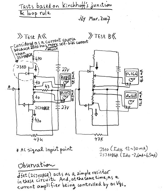

Indeed...but aren't you driving the Gate negative?

Hi Grey,
You could find the answer to your question from the attached
sketch. Iwill post pdf also on my thread.
:darkside:

William,
What is observed is not unexpected.
A JFET has much lower transconductance at about 30mS. On top of that you have put in about 50 ohm source degeneration. So you open loop gain for the first stage drop from say 25 to 8.5. On top of that, you are using a cascode (2SJ103) which has almost identical Idss to the driver (2SJ108), so that you are not getting much Vds across the diff pair (I doubt if you get much more than 1V).
And you would expect the open loop bandwidth of the second stage to almost half, especially in a high power AX where you have many power FETs in parallel, since you increase the signal source resistance (which is essentially determined by the drain resistor of the diff pair) by a factor of 2.
And since you are already operating at or near Idss, you are asking your JFETs (both the driver and the cascode) a lot to swing 2x bias, especially the cascode which has much large change in Vgs and hence would essentially switch off your driver JFET by making its Vds near zero.

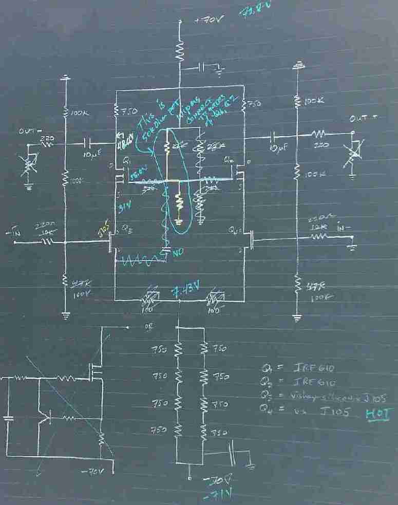

Here is a hopefully readable schematic of the cascoded BOSOZ. I made some changes to increase the gain as would be needed for an amp front end. This really increased the power dissipation across the jfets. These are vishay j105's -- that is all I had populated in the boards. ( I have some u1897's on hand, and also some 2n4416's....)
Ignore the scribbled out lines--the diagram was for testing a preamp circuit operating just above unity gain.
JJ

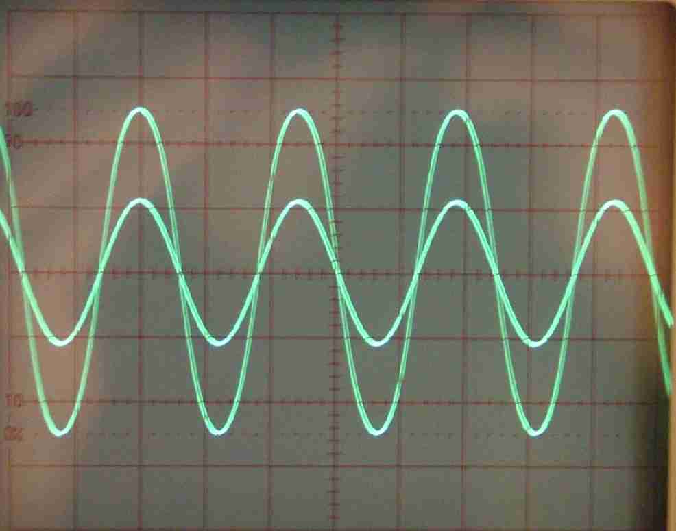

Well I checked the schematic -- it is barely readable. I will try to fiqure out a way to post a more readable schematic with what I have on my computer.
Anyway, here is a pix of the input and output. The input is the smaller sinewave, and the major divisions are 1V. The larger sinewave is the output, and the major divisions are 5V. I backed off on the magnitude of the input sinewave until the flat spots showing up on the tops of the output sinewave were just about gone. I think you can see it a little bit if you look closely.
The jfets, vishay j105's are supposed to have an Idss min of 500mA.
Again, this circuit was tweaked for use a preamp circuit that was driven single ended -- I'm sure much better results would be had if it were optimized for an aleph x input. Cascode modulation seemed to work wonders, but it is a bit difficult to implement when using a single ended input.
Any comments would be appreciated.
Grey- Is there a particular problem with driving the gate negative -- actually, now that I think about it, I don't think I entirely understand the question -- the BOSOZ has n channel devices, and the J105's have Vgs off of app. -7 volts. So those gates are negative with respect to the jfet sources. But these are p-channel devices.......I am trying the understand the problem you were seeing.

So, your source output is allowed to see the +6.73V?
Babowana, not sure how you got this number, I know the pix didn't come out too well so here are the voltages (DC), (a bit tough to read on the dwg):
gates of input jfets 0 (vishay siliconix j105)
source of input jfets 7.43 V
drain of input jfet 31 V, also source of cascode mosfet
gate of the cascode mosfet 35.6 volts (irf 610)
drain of the cascode mosfet 48.6 V
The voltage on gate of the cc mosfet had to be cranked up to get the roughly 12.5 volts output before clipping, but this dumped much of the load on the j-fet.
JJ
