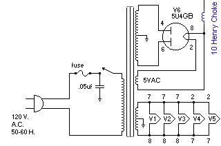

I found a great Double EL84 Push-Pull amplifier schematic (28 Watts) but my problem is that I can't find adquate power transformer. I need the following :
Primary : 120 Volts / 60Hz (Canada)
Secondaries : 2 X 220 Volts and enough current for 4 EL84 tubes + 12AX7
As for the 6.3V, I can cope with the idea of an extra transformer
Anyone know where I could find this ? Hammond seems to have one with correct voltages but it doesn't provide enough current....
Also, would it be possible to use a switching suppply instead ?
Any information would be greatly appreciated !!!

Elkaid,
Why two secondaries? This is more than enough transformer for you for an EL84 amp...
270HX 176VA, sec. 275-0-275, DC ma 200, Fil.#1(rct) 5.0v @ 3a ct, Fil.#2(htr) 6.3v @ 6.0a ct
220V is too low, IMO. I'd run EL84's with at least 250V on the plates. And I'd run them UL too.

Thanks you very much 🙂
I've attached the reason why I'm looking for a 2 X 220 Volts 🙂 .
Also :
Should I connect the suggested transformer exactly the same way as on the schematic ? Will the voltage be too high once the two secondaries connected to the two diodes ?
Also, correct me if I'm wrong but I thought that EL84 were drawing around 60mA each. So a 200mA transformer is a bit tight right ?
Thank you !!!

Ok, I see why you are confused. That's not "two secondaries", it's 220V, center-tapped.
You only have one secondary.
And the current draw depends on the op point you chose, but if you like, go for the 250mA model that Hammond makes.

According to the original Power Supply schematic, we're supposed to get around 300Volts DC if I'm correct.
Using a higher voltage transformer implies that I'll get a higher voltage at the output of the power supply. Is there any risk to blow up something ? (my experience taught me that TDA7294 doesn't like little overvoltage).
Also, I guess that I'll need to increase capacitor voltage (previously rated @ 400Volts)

I would...
a) get rid of the diodes.
b) use the 300V-0-300V@250mA hammond transformer.
c) use a 5U4GB rectifier tube, and a 10Hy choke immediately after it.
This will give you around 250V.

Joel said:Ok, I see why you are confused. That's not "two secondaries", it's 220V, center-tapped.
440v CT if you want to get technical.
220v either side of the center tap 🙂
I would drop the SS power supply, and use tubes, but thats personal opinion.

Elkaid, I would just do this as a monoblock configuration. Otherwise it's just too much stuff on one chassis.
