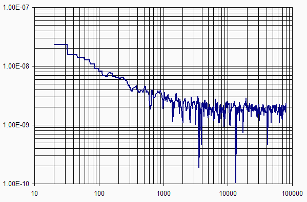

It will be a +12V and a -12V version, some prelimenary specs;
- noise 2nV/rtHz (a MC7812 is doing 200nV/rtHz)
- 20kHz bandwidth noise 0.280uV
- PRSS >>100dB
A picture of a noise measurement.
