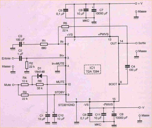

I built this TDA7294 amp several weeks ago and I've got some questions indirectly related to it.
1. I'm using a 500VA (2X30V) toroidal tranformer to feed two of these modules. When I switch it on, my fuse keeps blowing up so I replaced them by a Slo-Blo one but is that normal that I must use an 8A/250V one ? Is 2X30V too much considering that the TDA7294 is rated at +-40V ? (I'm simply using the transformer and a diodes bridge connected to two amp modules.)
2. Do TDA7294 have tendencies to blow up or explode for unknown reasons ? 🙂
3. I blew up a speaker because I had DC on one of my Output. Do you have any idea on how to protect my speaker from DC ?
(At least, my blown speaker was a test speaker retrieved from my car hehehe)
Well, thanks in advance for your help !

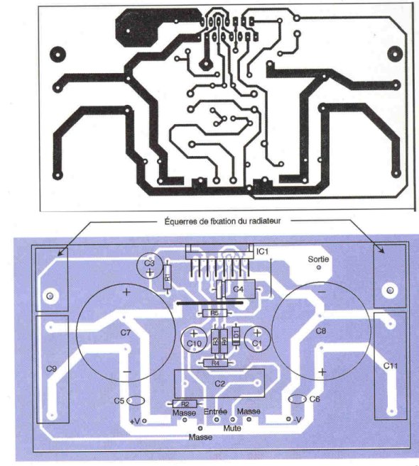

More & Better Information, PLEASE ...
The Layout of Cicuit + Power Supply.
How the parts are placed. Is a PCB-card used?
This is just as Important for function
of an IC AMP.
So it is not easy answering your questions
by only a schematic.
Better some pictures
and some PCB-layout daiagram.
THen I promise you will get more answers,
that CAN adress your problem 😉
/just a little hint
from halojoy

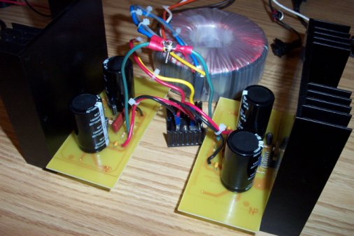

And this is my amp....
Pretty simple.... almost not protected at all (only a fuse on the main). I hope to improve this amp using all of your tips and tricks which could make it better 🙂
Thanks !

One way to protect the speakers from DC is a cap on the output, it's seen in many Class-A amps, but with your IC it shouldn't be needed. You said you blew a speaker, what did you change after it blew?
There's a softstart circuit over at sound.au.com .
Usually it's normal to use a slowblow fuse, try using the smalest value that doesn't blow. Charging caps takes alot of current, so switching on causes the most current to be drawn, although a soststart circuit would help that. Maybe use a thermistor like in the pass designs.

Well, I'd only use the cap if you're excessively paranoid about DC getting to your speakers. The cap will act as a highpass filter, so you want it to be a high enough value so as not to attenuate frequencies you want, somewhere around 5000uF would be fine. DC won't flow through a cap, so your speaker would be protected from it. Again, some say that a cap in the signal path can degrade sound quality, keep that in mind.
As for a 60Hz hum, it could be a ground loop. I'd check there first.

If I take a look at my picture previously posted, the two module's ground (Green Wires) are connected to my transformer secondaries (Blue & Grey wires) at one point.
Should I connect my speakers' (-) at this point too ? Could it be the cause ?
Thanks again ! 🙂
Hi!
Yeah, normally I would connect speaker's - to the star grounding point...
As for connecting amp-ground to chassis: Put a MKP between ground and chassis (I always use Wima MKP 10 0.47 uF, 630 V DC), again this prevents humming

sure a serious absense of knowledge to proceed properly with this .....
you need to make sure
- pcb is correct
-construction has no errors
-no short circuits between traces and or other error
-missplaced parts
-proper power connected
-proper ground set up ( wrong one will cause the ground loops )
if you havent made any mistake to all this your amp will work perfectly BUT !!!!!!!!!!!!!!!!! it will be not easy from forum members to advice you sine from the way you post it looks that you are a rooky .... ( everybody has been one )
the think is that with this circuit and this power sup everything will work fine with very little or no dc at all in the out
so for sure you have some construction error ..... to find it you need to read a lot ..... a wild guess by me or any other forum member has one chance in amillion to solve the problem ....
