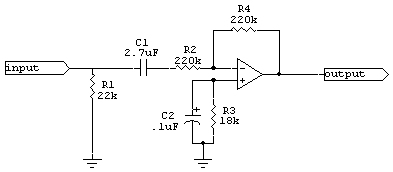

Is the attached circuit as you described? I have a really bad hum now. For C1, I used 2.7uF because I didn't have 2.2uF. It shouldn't matter, I guess. I also tried changing R3 to 220k. No difference. Could you (or anybody) tell me what is wrong? Of course, I used a star ground.
Thanks.
No, of course not. The 22k Resistor goes on the Power Op-Amp Chip's INVERTING INPUT, as I wrote. NOT on the Amplifier input.
Also, I'd think you could in most cases ditch the input coupling capacitor, if you need it, try 0.1uF Foil/Film.
You did not wire as direccted in my original post, reading:
"Place a 22k resistor between the inverting input and ground."
Sayonara

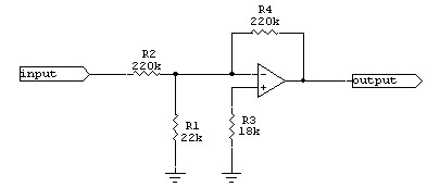

Thanks to Kuei Yang Wang, prototype gainclone with unity gain is finally working. The chip doesn't get hot at all. Like he wrote, it's almost magic to me. I'll order some quality resistors and make a real version of it.
BTW, I would guess that the 18k resistor is for impedance matching for both inverting and non-inverting inputs. The impedance seen by non-inverting input is 220k//220k//22k which equals to ~18k. So, I can understand how it comes up with that value. But, what is the role of 22k resistor?
If I want to set the input impedance to 47k, should I replace 22k with 4.7k and 18k with 3.9k (or with the closest standard value)?
