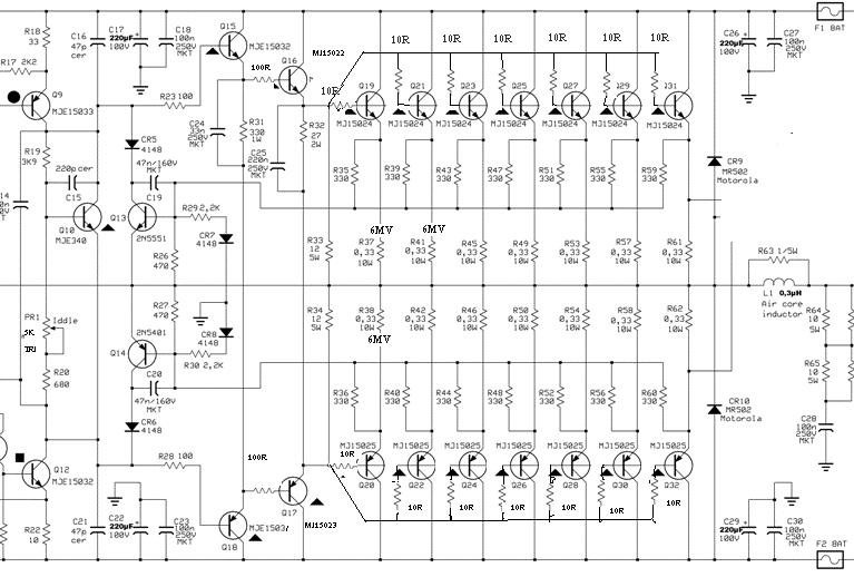

i have drive pa(Q16/17=MJ15024/25)BIAS=5K/6MV and i,m adding 10r for eavry base of mj .and it,s work very will?
