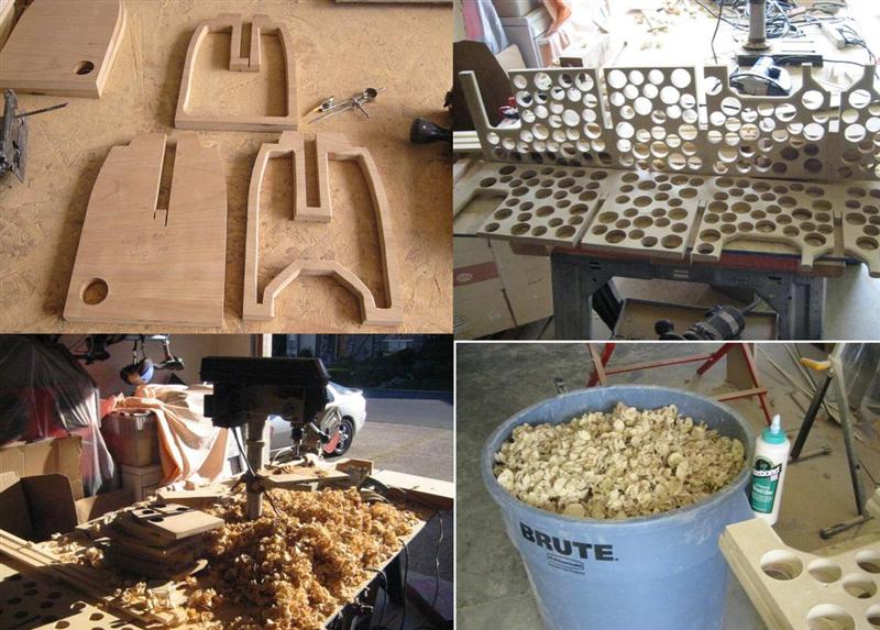

I am building a curved small Thor gleaned from the hard work of many contributors. I have attached a few pictures of my progress.
Question(s) to those with experience in such things;
1) Is it necessary to compensate for the lost interior cabinet volume due to the semi curved back side? If so, can I increase the cabinet depth by adding another front baffle with the appropriate amount of material removed to equal the lost interior volume? (similar to cutting "H" braces) it's ~141 cu. inches
2) Should I add additional weight to the cabinet? What is the purpose of additional weight? Prevent speaker roaming? Ala Subwoofers?
3) I've called the owner of Piano-Lac and he no longer sells to us DIY'ers unless a commercial address is available for shipping. He stated he had a problem with liability issues. I don't know anyone with a commercial address where he can ship to COD. Any Ideas?
4) Any problems with rubber feet on the bottom of the cabinets instead of spikes? I have laminate floors on a raised foundation.
Man, That MDF makes a mess! :hot:
Thanks for your help.
Ron

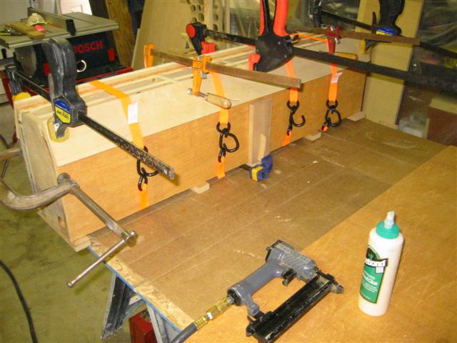

Some more pics of progress
Strappin' down those wild beasties....ummm no.
As expected I made a mistake here in this photo. Yep. It's not placing the straps directly over the internal bracing. Caused the cabinet sides to warp!:eek: I was able to correct this faux-pas by cutting spacer blocks 3/16 wider than the internal diameter and forcing (spreading) the sides apart. Learning as we go.

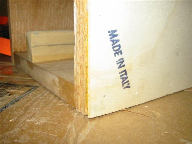

I have 2 layers of 3/8 bendy ply on the cabinets now and used copious amounts of gue on both sides of the lay-up. Shot the ply down with 1" pin nails ... a little long but will not bother anything down the road. The bendy ply was a touch on the rough side (looks like resawn lumber) so I am adding a 1/8" skin on top of the existing plywood sides. The 1/8 ply is also bendy ply buy has a VERY smooth exterior to mate with the cherry veneer that will 'Purdy -em up. I'll post more pics again when I complete the next stage(s).

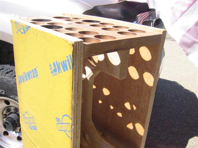

A knot in the verticle spine caused a slight bend in the cabinet shape near the top, this was cured by relieving some tension on the inside of the bend. This method works well, and straightened it out overnight. Wood is not ever perfect. So we do our best.

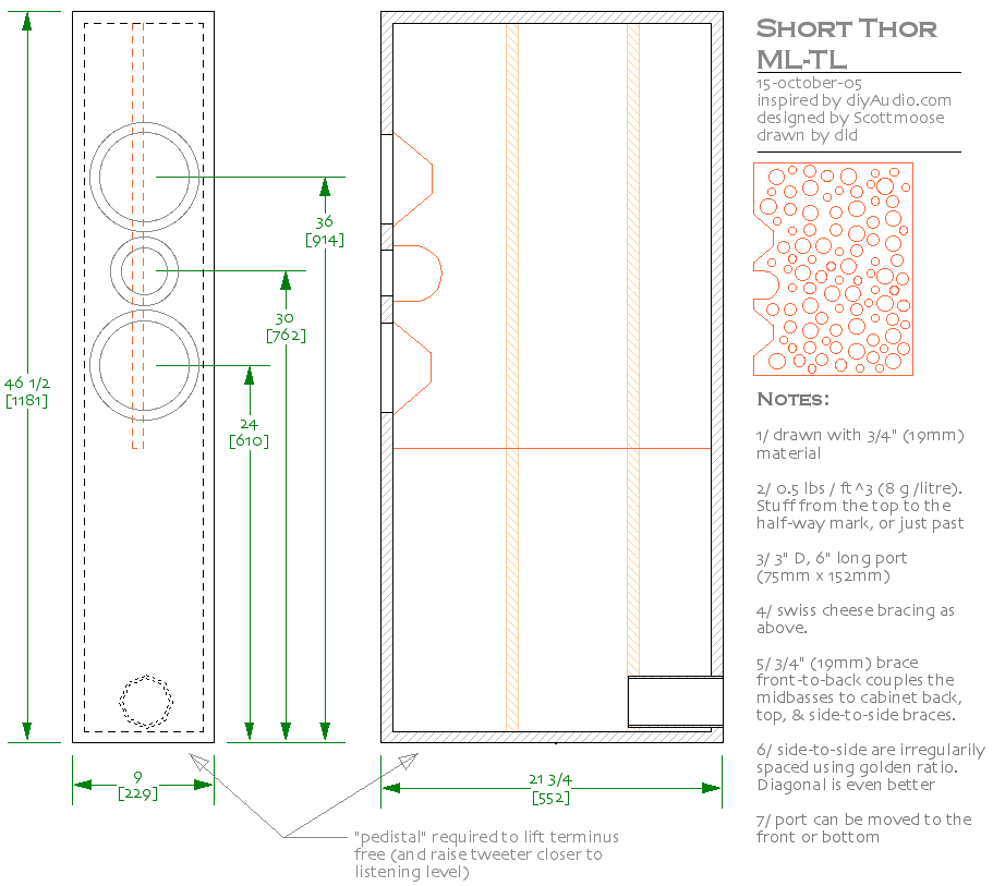

I thought that the Thor was a transmission line design though?
If you are asking questions about maintaining internal volume in a bass reflex or sealed cabinet, this is worrying. If you are asking the same question with regard to a transmission line, have you missed the whole point? In a transmission line the cross-sectional area of the line is crucial and needs to match the design. You can change the shape of the cabinets as much as you like (baffles may need correction), but at the end of the day the cross-sectional area of the line needs to increase/decrease along the line according to the designers specification.
Have I missed something?
Well, the Short Thor box Dave and I designed is not a Bass Reflex cabinet. It's a Mass Loaded Quarter Wave Resonator (Or Mass Loaded Transmission Line). Having said that, yup, cross section needs to be maintained as per the design; MLTLs are no different to other boxes in this respect.

My reason for asking earlier about cabinet volume is because I read (somewhere...can't remember exactly where now) that 5%or less cabinet volume would not affect the way the drivers perform, as they are probably out of spec (with each other) by that amount or more. The speaker design is not sealed or bass reflex and I have kept the baffle cross-section area and size the same. I have kept the volume (as best as I could) to within 5% or less of the specs provided by Mr. Moose. The crossovers will be build to stock specs but with HI-End components, better than the parts used on the upgraded Xovers offered by Madisound / PE. In the end I hope they sound better than the original design by Joe D'Appolito.

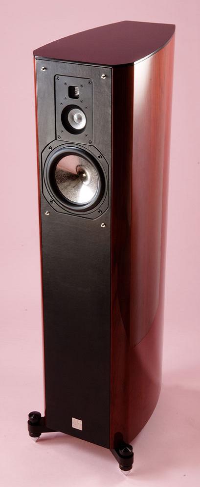

I have modified the cabinet to resemble the Volent floor standers as they have been approved by the highest power in the house....WAF. ;)
Cabinet volume was recovered by extending the rear of the cabinet 3/4" and not including some of the bracing in your original drawings of the "Small Thor". Hence my earlier photos of "Swiss Cheese". Bracing is accomplished by 5 ribs horizontally and 3 verticle "spines", the front baffle will aid in stablizing (sp?) the front between the ribs, the main spine contacts the rear wall as well as the rear of the front baffle, I will post picts.

Oh yes. LF will not be a problem :devilr: Seriosuly though, extension, but no boom -I shaped the FR to roll off in step with average room gain. Expect grunt to the low 20Hz region from Short Thor providing the room supports frequencies that low. Re the difference between MLTLs and BRs, I've covered this a few times in other threads, but briefly:
An MLTL (or MLQWR to be more accurate) is a straight QWR. By restricting the area of the terminus by means of a port, you create an air-mass which resistively loads the quarter-wavelength resonances generated by the line. This does several things, the most significant of these being a) it lowers the fundamental resonance of the cabinet, and b) reduces ripple in the passband. There's more to it than that of course: for a full-dose of theory, go to my friend Martin King's site: www.quarter-wave.com and have a read of his white papers and projects. You'll find the documentation of his Project 2 ML TQWT particularly useful. Also, Bob Brines has some useful articles on his site: http://www.geocities.com/rbrines1/
And that is the problem with original Thor... the cab was designed using Augspurger's (scanty) alignment tables and then the cross-section was arbitrarily reduced by a 3rd which ended up giving a (properly) measured response only down to ~100 Hz.
