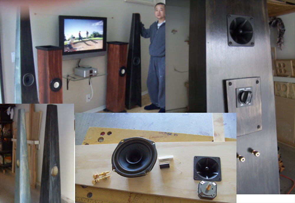

Home Depot special, should've checked my custom stain, was supposed to be "classic ebony" but they gave me "sick blue" stain..., the stain was a disaster, after the first coat of "sick blue" I tried 3 times to stain with "classic ebony" but the bluish hue sneeks thru. may try to paint over it with combination of red/black with cold stripe. I will also install "feet" of some sort.
Like to thank "Zilla Speak", Jeff, for hand holding me thru installing of piezo speaker on the back, works beautifully, I am trying to find the right L-pad setting, high end "sparkle" was missing on my previous BIB speaker. Can't believe piezo is less than $2.
Metronome with my radioshack driver is overall good sound, but compared to BIB it lacks base, others are right the subwoofer is needed. I have one and will use it. First day I am just using the speaker without sub (with my Kenwood amp with "loudness" button. Sounds good, as long as I don't look at the cabinet finish...)
Once I get the right finish/paint, I will like the speaker I am sure. I like the shape, I will dial in the right amount of high freq ("sparkle" as Jeff calls it), and use my cheapo Sony sub.
Despite my stain problem, would encourage others to build metronome (little harder than BIB), and don't forget to add piezo tweeter.

I like blue, but not that blue
You've obviously got the bug now. That's like, what, the third pair you've built in the last few months?
Good luck getting your finish sorted.

blue + black looks kinda cool & "designer-looks" - very nice woodwork even if that stain didn't work yet as intended.
freddi said:blue + black looks kinda cool & "designer-looks" - very nice woodwork even if that stain didn't work yet as intended.
made up my mind will paint it, dark black and firey red with gold stripes. As is doesn't show up my router edge work...

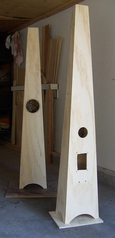

I am debating whether to follow your project that u have detailed, or build a BIB and just add a piezo in the back. I like BIBs...

I have used it without a modification, it does add a little sparkle that can be adjusted.
