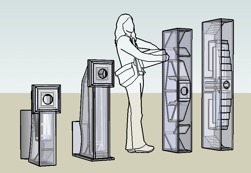

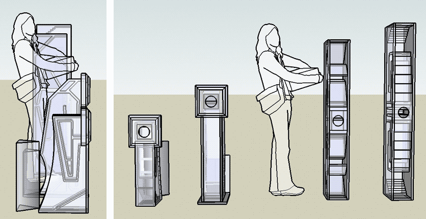

To give an idea of the relative sizes of these horns.... note that the female is taller then average... probably 5'6" (168 cm)
dave

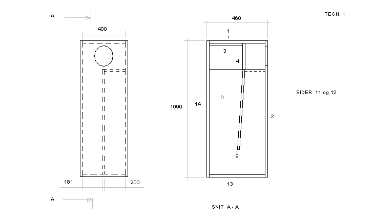

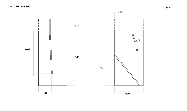

Dave, I designed theese for a friend, I havent heard them yet, but he says that midrange on his FE167 is good and seems to be pleased with them
you may do with them what you like, maybe they need a bit simulation
mouth has a little trick, but I dont know how that works
