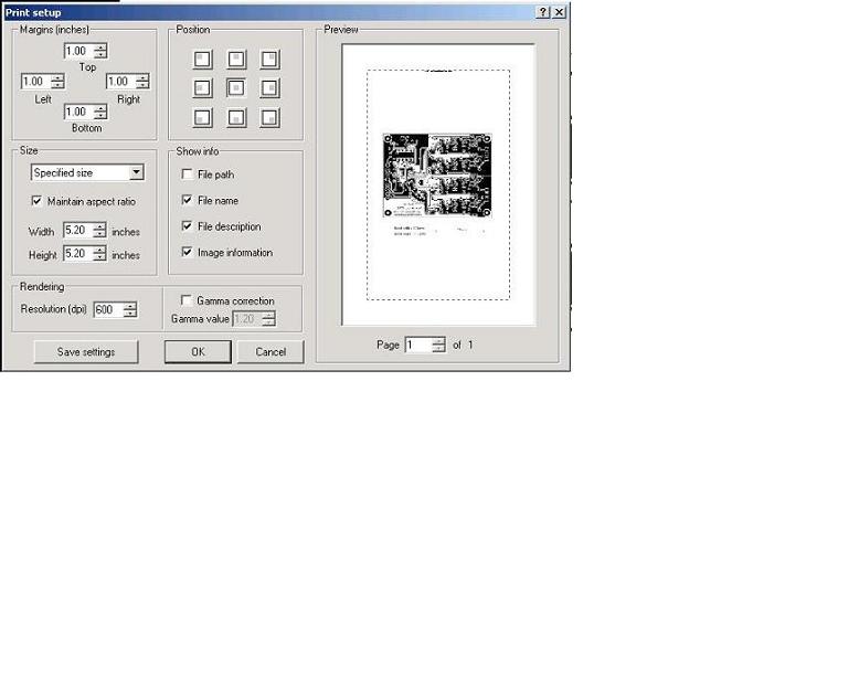

PCB on Lars's site
Hi
I made the pcb yesterday. Here's how I did it.
Save the layout pictures. In AcdSee you set the picture to specified size. With a 300 dpi resolution the size is 6.20 x 6.20.
With 600 dpi it's 5.20 x 5.20.
Worked fine on a 2 different HP printers.
/Henrik
P.S.
I find the pcb pattern a little to tight for home making. Hope to get some comments from you guys 🙂
