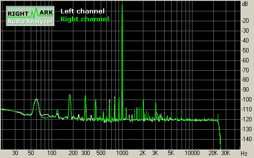

Pasul said:Do you have any picture of THD distortion of this amp?I like to see it.THX
I tested the THD distortion output from PDB without NFB and any load,
( just as a line loopback ). I can't borrow my friend's AP2 tester
this time, so I used SB X-Fi card and RMAA5.5 to test the amp.
The THD picture is as attachment:
Parameter Left Right
THD, %: 0.0016 0.0019
THD + Noise, %: 0.0111 0.0154
THD + Noise (A-weighted), %: 0.0093 0.0121

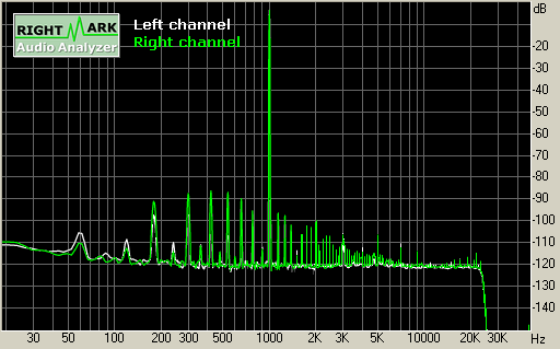

Another picture is the THD of the amp's driver:
I tested the THD distortion output from DB of the driver with NFB ,
( also as a line loopback withou loading).
Again I used SB X-Fi card and RMAA5.5 to test the amp.
THD, %: 0.0019 0.0022
THD + Noise, %: 0.0095 0.0092
THD + Noise (A-weighted), %: 0.0081 0.0080

Hi Mtlin,
What about the sound quality of your amp, i mean to say bass, speaker cone movement control, mid resolution and treble details...I am also doing similar to this but with all N-channel mosfets...
regards,
Kanwar
regards,
Kanwar
Workhorse said:Hi Mtlin,
regards,
Kanwar

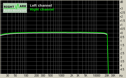

Hi Kanwar,
I'm glad to tell you that this amp ( or SPLIF topology) is really good.
I can't describe how good is the sounding, but I can tell you its
frequency response is almost flat ( 20 Hz to 20 kHz, dB -0.27, +0.01 )
just like a DC coupling pre-amp.
"Fast speed, powerful, low noise, low distortion, transparent, very detailed and live..."
my friends described last time tested with Phil Jones' Platinum Audio trio.
Though they asked for an AB TEST between SPLIF and global NFB,
they wanted to know the bass can be improved or not, but we didn't have enough time.
- Should I call this pre-amp+ PDB a "SPLIF" Amp?
