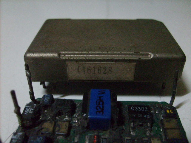

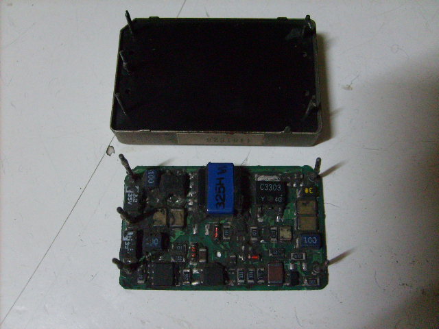

razirafi said:I don't know if this is the part number...
Looks like a modular DC to DC converter to me🙂 Nice pics THX

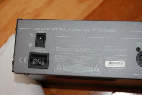

Thanks, I spent some time researching this conversion last night with very little success, This is not the first time this forum has helped me out. I bought a cheap samson E62, I'm not sure on the specs, but it's cheap enough that I can experiment on. I want to power it the cleanest way I can. This will be for a SQ car, and I need to hook it up before Spring Break nationals. An EQ was one of the main things I was missing last year, and I just couldn't fork over the cash for a 12 volt equivalent. Please keep an eye on this thread as I intend to update it with some additional pictures once I receive the unit.

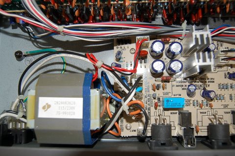

since I have been thinking of doing the same thing for a while now and the thought of running 5 pairs of RCA lines from the front to the back of my car puts me off, I thought about having a look into my 31band EQ........
my unit is a local brand (low cost but nice quality) and I can see a dual mono construction. it contains four boards in all. two holds the main circuitry and two attaches to the front panel containing the slide pots.
it is a dual mono construction and the main board already has on board regulators. it also has two power transformers, one for each channel. the transformers have center tapped outputs so the board accepts two AC terminals and a common making three pins. a SMPS can easily be connected to this, the ground connected to the center tap terminal and +18 and -18 connected on either pins. 18V is needed because of the voltage drop due to the on board regulators.

same as what I saw in mine except mine uses two transformers.
you can connect a +/-18V supply to the connector going to the board from the transformer. the +18 and -18V connected to either red wires (any polarity, +18 to one red and -18 to the other red) and the common connected to the black wire.
you just need to look for a good +/-18V DC-DC converter with around 500mA output current.

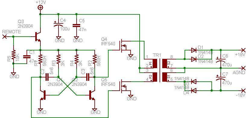

I was able to modify my EQ to be used with 12V.
instead of buying a ready made DC-DC converter, I made a simple fully discrete unregulated SMPS (no need for regulation since the EQ boards already have built in 15V regs.
here's what I took just a few mins back......
a shot of the very simple SMPS:
