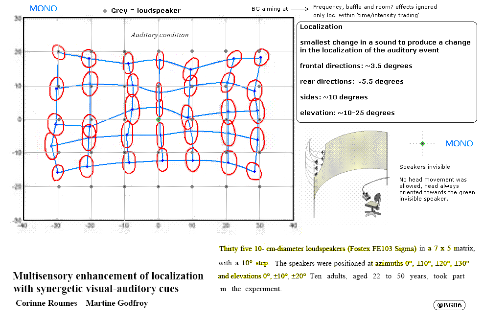

MTM sounding right is one important primary issue to target but there are many other issues that make the MTM concept difficult to get right and one of them that bother me is the wider vertical localisation error compared to other configurations at shorter distances e.g. when listening close to a normal MTM.
A time ago I discussed this with a friend and saved some notes I made that maybe could wake up someone’s others interest?
See the pics that I first hesitated to submit due to the inherent information quality I really think I should improve before posting in order to avoid the risk of getting too many questions back in return….
Observe, it’s only about comparing localisation and probably the direct appearance (within time- intensity-trading < 700 uS) of apparent phantom sizes not including horizontal/vertical frequency dependent azimuth errors that smears and blurs the whole soundstage further and of course not how the MTM sounds.
That’s another story with separate questions concerning primarily listening preferences and thus beyond the scope of the pictures.
