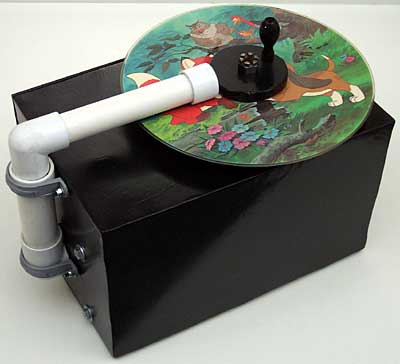

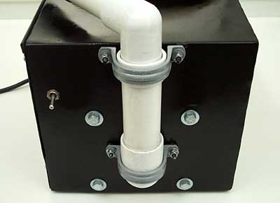

I built this DIY record cleaning machine about 6 months ago. Total cost was well under $50. The most expensive parts were two VPI brushes at $9.99 each.
The cabinet is 14 gauge steel from an old pressure washer cabinet. I cut and welded the steel to 15" long x 10" wide x 9" high. There's a removable panel on the back for access, and vents on the right side for efficient airflow. The inner left side is reinforced with angle iron to support the vacuum motor. Finished in glossy black Rustoleum.

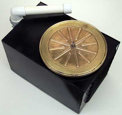

The 10" brass-plated steel platter and its support were cannibilized from an old Victrola player my brother gave me. The platter was polished and finished with clear acrylic paint.
The vacuum motor was pulled from an upright model bought for $5 at the local thrift. I had to fabricate a heavy steel plate with a hole which slips over the outside of the motor. The plate was drilled and tapped for 3/8x24 thread and four long bolts pass through the left side of the cabinet and into the plate. When tight, they pull the motor against the inner cabinet. A little silicone caulk provided a perfect seal. The outer vacuum tube is made from common PVC plastic from the hardware store. Black velvet strips protect the record surface.

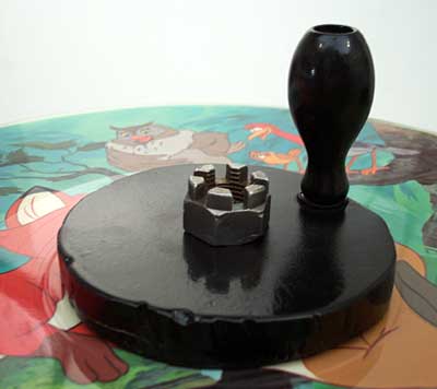

The clamp is a piece of 1/2" steel plate. There's a circular gasket (from old truck innertube) glued onto the lower surface, for good grip on record lables. I welded a short piece of a 1/4" bolt onto the original spindle, and ground teh weld smooth. The large castle nut is from a Willys shackle bolt and there's a 1/4x20 nut welded inside it. The castle nut is large enough easily hand-tighten the clamp.

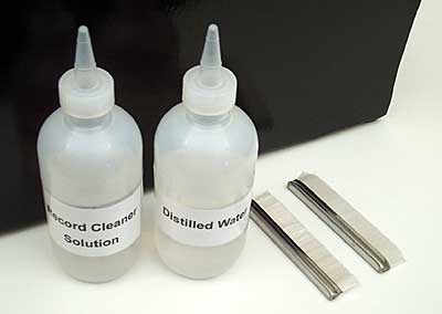

The record cleaning solution is also homemade:
2 parts distilled water
1 part 91% Isopropyl Alchohol
A few drops Photoflo

Cleaning:
A small puddle of Record Cleaning Solution is placed on the record. Using the brush (held in my left hand) the record is vigorously scrubbed, working the brush deep into the grooves as the record is rotated back and forth with my right hand.
Then distilled water is placed on the record and the process repeated.
Then the vacuum wand is swung over and onto the record with the vacuum sucking all fluid and dirt off the disc.
The record is now totally dry and clean, ready for play. All cleaned records go into new plastic innersleeves.

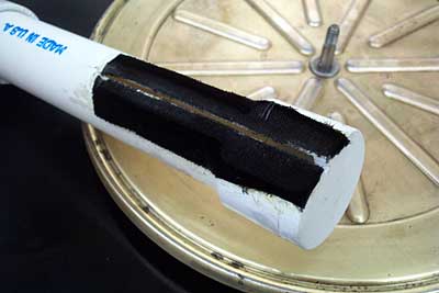

Detail of vacuum wand. These common plumbing parts were shaped with a file to create a flat, smooth surface to ride on the record's surface. A Dremel tool with cutter was used to form the slot. Black velvet is glued next to the slot, to prevent scratching of the record.

What did you use to glue velvet stripes to the sucking hose?

I used contact cement to glue the black velvet onto the PVC tube initially, but it was not secure and loosened after cleaning about 100 LPs. So I then used 5 minute epoxy with much better results.

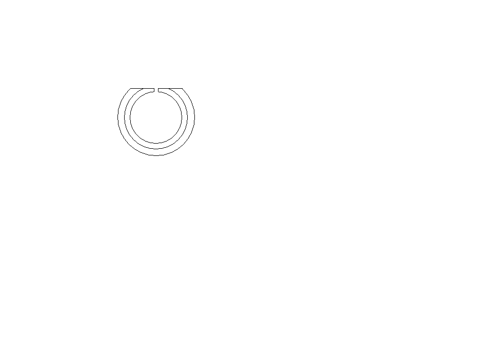

Details on the suction tube assembly.... Yes, the sketch you posted is correct SY. The end cap was filed flat on the underside, prior to attaching the black velvet.

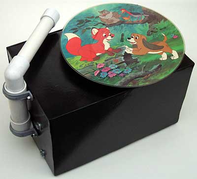

The tube bolted to the cabinet is 1 1/2" PVC. The upper 'swinging elbow' portion is made from 1 1/4" pipe. The smaller pipe fits loosely into the larger pipe. A few wraps of black electrical tape around the smaller pipe made a better fit, reducing air leakage through this area while still allowing easy swing rotation.
The swinging elbow must be held in position with the left hand while the right hand rotates the record. I considered welding on a stop bracket to hold the swinging elbow in place (over the record), but it's an easy procedure without it.

I used electrical conduit for my wand 3/4" with an elbow for same. I just used a dremel tool to cut a slot up along the bottom and then used contact cement to put on some velvet. The brush type draught excluder makes a good brush for wet brushing the surface. A second wand is convenient here.
