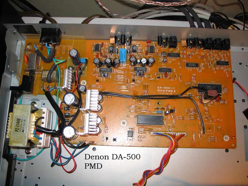

The Denon DA-500 is a simple & fairly cheap DAC, and I found one used for the right price.
It has the BB PCM1702 dac-chips, so it should be possible to modify it into something reasonably well...?
Well, the masters of "don't waste parts", did not sleep in the KISS class.
PSU supply-decoupling is no problem; there are non...

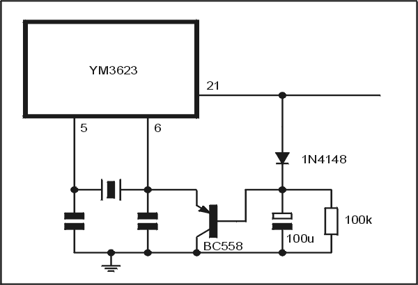

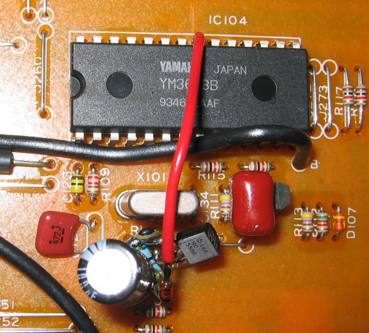

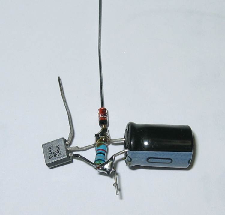

Well, I started with the clock, or, "how to kill the clock".
Since it has a Yamaha YM3623B, I used the suggestion posted here some time ago.
Looks like this:

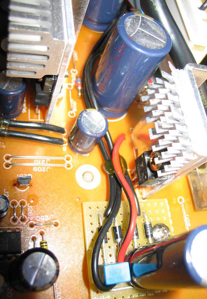

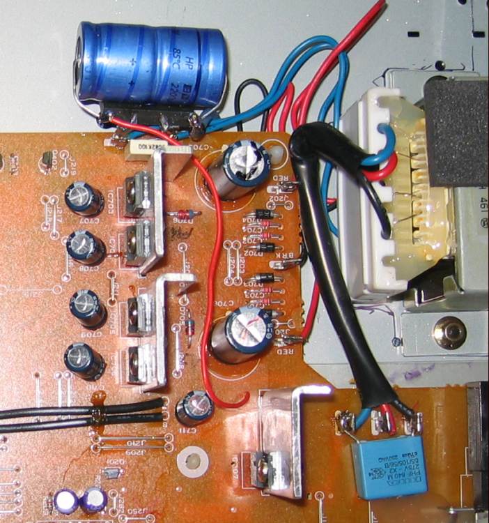

Then there is the PSU...you can do as much as you want...
Stock it is 7812/7912 for +/- 12v(analog), the 12v is further reduced thru 7805x2/7905 for dac & digital use.
And, wait...there are a unused secondary wire-pair..in mine it gave ~8,5V ac. So I put a bridge on it, a cap, and wired it up to the digital/control-7805, and cut the pcb-trace it used to have.
These few parts were well spent, and made a big difference!
My way:

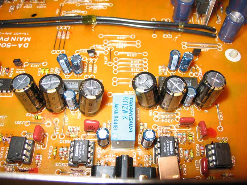

Op-amps were swapped, a few extra caps mounted, DC-blocking caps exchanged...it sounds much better.
If you have a similar unit, Try it!

Cobra2 said:Well, I started with the clock, or, "how to kill the clock".
Looks like this: [/B]
So what does this clock killer circuit do for you? in other words. why do it? Just want to know.
Hi, I did the "clock-shutdown" mod as well, replaced the 4 opamps with opa2134 on sockets, replaced the 4 standard diodes in the psu with skottkey ones, replace the powercord with a iec socket.
Before the mods the sound was nice but a bit dull, and the soundstage had not much depth, it was only wide. Now it has some depth in it.
My questions:
- how can I check if the clock mod did work (I only got a simple multimeter)?
- Do I have to use extra decouple caps on the opa2134's ?
- Can I swap the opa2134 with LM4562NA's (and wich one's as there are 4 of them, say you only got 2 LM4562NA)?

Check voltage at pin 6, when input is locked, this should be lowered towards 0, as the transistor will be "on", and short the E-C connection, shorting the cap, and "killing" the clock.
I would not waste expensive op-amps everywhere, the 2 closest to DAC (the centre ones), are the output buffers.
The other two are just active filters. Use the "low-noise" 4570 here.
There are 2 DC-blocking caps, close (one on each side) to the mute-relay. Exchange the simple el-lytic caps, or bypass with good film-cap.
Coax instead of optical: do as the other coax-inputs...: add a 7404 (2 ports is used for 1 input)

You can stop the clock on YM3623B with just one 1N4148 diode too ( like Elektor did on their PCM1710 MiniDAC ). Elektor claimed the diodemod to stop the clock makes an improvement of 6 dB in THD+N , measured with a bandwidth of 30 kHz. They also used 16 MHz cristals but this was not enough, although it has no relation with the samplefrequencies it still interfered. Please see Elektor magazine of july/august 1996.

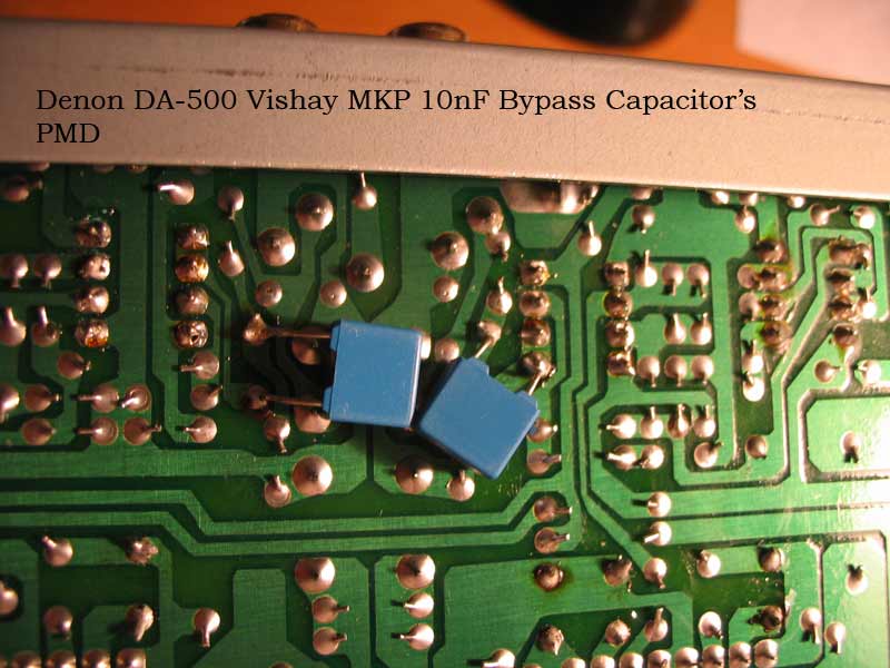

I purchased the DA-500 DAC from "Stofnest". He already did some modifications, he replaced the opamps and the diodes. Your little clock-"bug" was also introduced in this nice machine.
- I replaced the power capacitors by larger Panasonics FC
- Installed some bypass amps Vishay MKP 10nF near the mute relay.
- Installed a XY-capacitor in the power cord
- I improved some of the connections made by "stofnest"
This mods makes the DAC even more nice! Easy to do and great improvements.

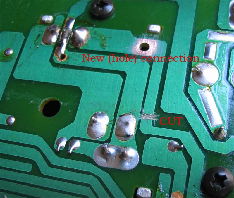

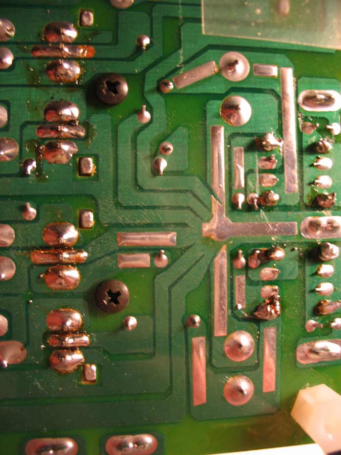

Now I would like to do the 5V trick with the unused voltage line. The 7812 is getting very hot (is this because the opamps are changed?), so I think this trick is good to relieve the load. And if it sounds better it is even more nice!!
I was wondering where you connected the (-) from your mod?
Did you cut only one power supply line?
May be you can show your connections/ cuts into the attached image.
Thank you!

- a XY-capacitor is also installed
- I connected the ground to the IEC socket and the XY capacitor
- Extra aluminum is attached to the radiators
- The PSU upgrade uses skottky's a large capacitor and a small bypass cap.
To be honest, i'm not sure if the sound made improvements. . . but The 12v unit doesn't get hot any more. So that is a plus.
