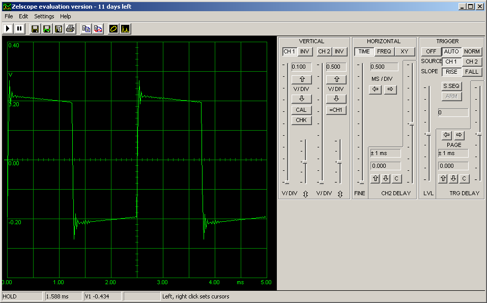

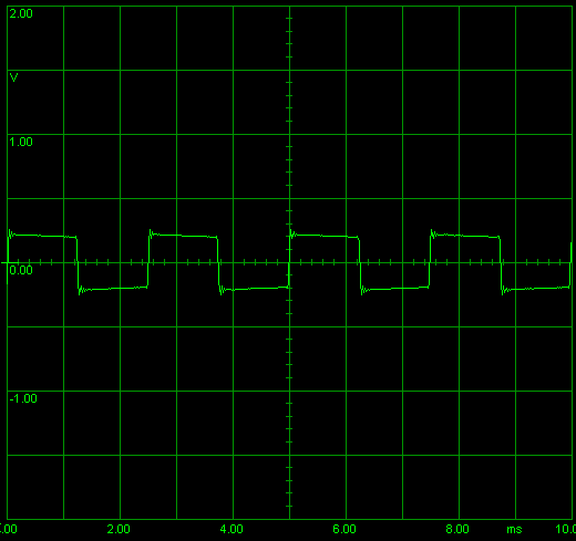

hi
At first some facts:
1. I used a test-CD with special test signals.
I have no doubt signals are of good quality.
2. I used my Technics Cd-player. It has got 24bit-resampling.
I set Re-Sample to ON.
3. I have Sound Blaster 24-bit Live! soundcard.
It is a medium quality rather low price card.
As can be seen in attachment,
400 Hertz square wave is not too bad.
But not perfect.
The quality when using this www.zelscope.com Software Oscilloscope
is of course dependent on the quality of your Sound Card.
Especially when dealing with square waves.
They may be difficult for a CD recorded with 44.100 kHz.

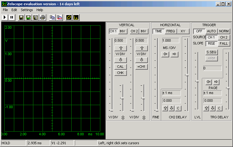

Here is an attachment of the Screen Capture of zelscope windows
and all the Scope 2 Channel settings options.
The first picture in post above was saved by using the built in
'Copy scope monitor screen to Clipboard'.
You can also 'Save directly as a .BMP image'.

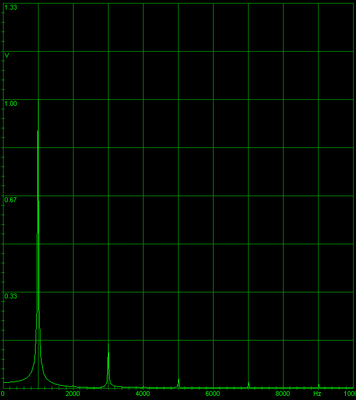

lineup said:hello
Here is a Fourier analys
of a 1 kHz sinus 1.0 Volt,
generated by my fucntion generator
Using Zelscope Oscillope.
Picture was exported using the built 'Export as .BMP'
Then I made it smaller and converted.
It's difficult to read the (linear?) scale but it looks like 10% 2nd harmonic?
