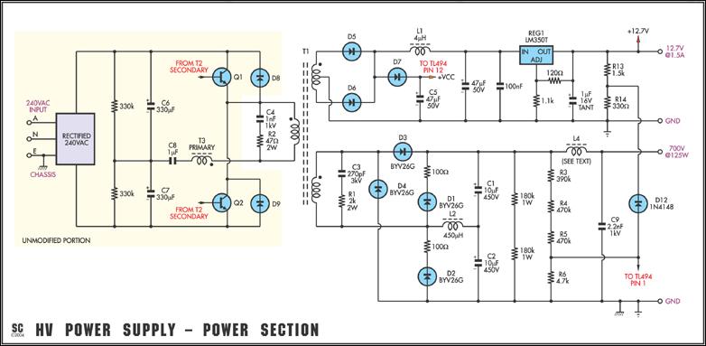

Just saw this article from 2004 showing how to convert a AT PC SMPS to regulated high voltage for use in Tube Power Amp
http://www.siliconchip.com.au/cms/A_102096/article.html
Only problem - you need to pay about $5 for access.
I just did and got the full article with schematics & description of mods
Quote from article:
"The circuit is capable of excellent performance. It maintains full regulation at up to 125W, with ripple at 2V peak-to-peak, or 0.3% at full power. This is quite acceptable, as most of the ripple is at twice the switching frequency (60kHz) and so is inaudible.
The 100Hz hum component is only 0.08%, which shows the excellent regulation of the TL494, since the rectified mains source contains 13% of 100Hz ripple at full power. Over-current protection is retained, with a LED added to indicate when it is active."

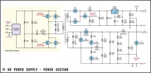

Final schematic below.
Has anybody tried this? How well does it work?

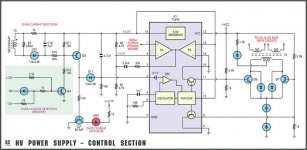

Can you post the regulator part of it? (the TL494 area).
Last comment, Have fun winding that transformer for 700V output with enough insulation. (something I would be scared to try
Also what is T3 for??? it's missing a secondary so it's not current transformer.

2 observations -
The rectifier for +700 is a doubler, which should make your work easier.
T3 is labelled "primary", so we can safely assume the driver part of the schematic has "T3 secondary" on it, and that it IS a current transformer (what else would make sense in that place?)

WIne&Dine is right it's a voltage doubler design.
Here are some more schema with the associated captions
"Fig.2: the schematic of a typical control section based on the TL494 PWM controller. The only changes needed here are the removal of the over-voltage detection circuitry and the addition of an over-current indicator, based on Q7 and an LED."

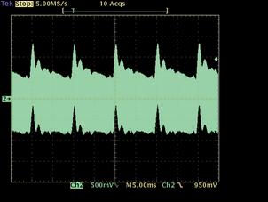

"100Hz hum can be seen on top of the 60kHz ripple and amounts to only about 0.6Vp-p.
Also "Primary side current is sensed using T3, a small current transformer. Its primary winding is connected in series with the primary of the main switching transformer. T3 employs a very large transformation ratio (n of about 180), combined with a relatively small resistance across its secondary winding
I missed that area of the schematic, that would help with winding too.
Your correct agin, as you said nothing else would make sense here.

thanks for the regulator part of the schematic, answers a lot of my blind questions.
