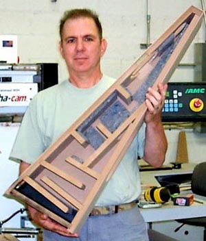

Hmm I didnt realize they were from the Meadowlark Swift, hence the name I guess🙂 Ive heard those Meadolarks and didnt think they were horrible, nothing spectacular except the bass which was excellent for such a tiny speaker. I wonder how difficult it would be to try and replicate that sort of transmission line bass loading but using the new madisound designed Xover? Any ideas on the volume of the box? I have the dimensions its 36in tall x 7in wide x 9.5in deep at the bottom and 3in deep at the top. And I have a picture of what the inside of the slightly larger Kestral2 looks like. Might be an interesting project instead of the standard bookshelf cabinet I was planning.
thanks
Are you saying these are better then the "swifty" kit??. Im kinda interested in trying a transmission line similar to what Meadowlard audio did with these drivers. Has anyone tried to clone the Meadowlark Swift but with the better madisound xover?? Ive heard these speakers and the bass was excellent for such a little driver. Problem is I have no idea about transmission lines, anyone wanna help me design one for these drivers???
