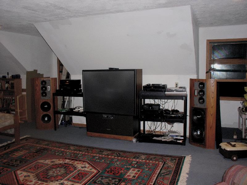

I posted a few pics here and there since starting them 2/2005, but v-bro and ruddyama asked me to start a thread with construction details...
plus, they keep evolvimg....😉
you probably remember this pic... note the absence of the 25" ribbon/planars.. and the second sono-subwoofer..
