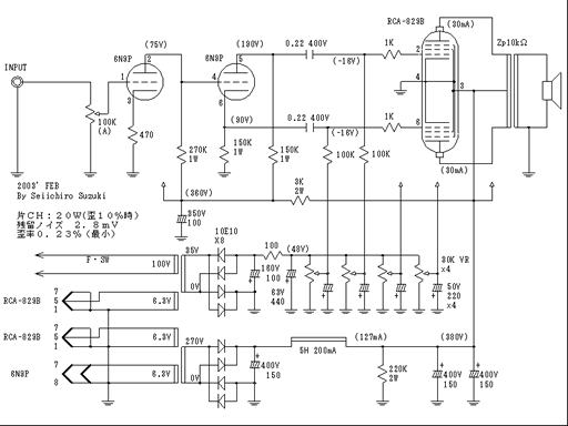

I have found a nice 829B schematic, using the 6N9P for preamp and phase shift:

http://www.pastisch.se/faktiskt/k_6N9P_829B.pdf
The 6N9P is confusing. I can find a (Russian tube) 6N9C = 6SL7 in my lists and a 6N6P = 12BH7A but not a 6N9P...
Ooops the 829PP was already posted.

The 6SL7 is known in China as the 6N9P:
US 6SL7
Chinese 6N9P
Russian 6N9S
Since the last schematic I have posted is from China (there are some Chinese characters visible in this schematic), the 6N9P is used. I have ordered some 6N9S tubes for the preamp and phase shift section of this amplifier.
I plan to use PP transformers from a local company (www.klare.nl) for this setup, they sell 30W PP transformers (8K primary) at a reasonable price.
The Chinese schematic promises 20W (@ 10% distortion without NFB...) using the 829 as power tube. Most 832 setups report about 7W in PP.
