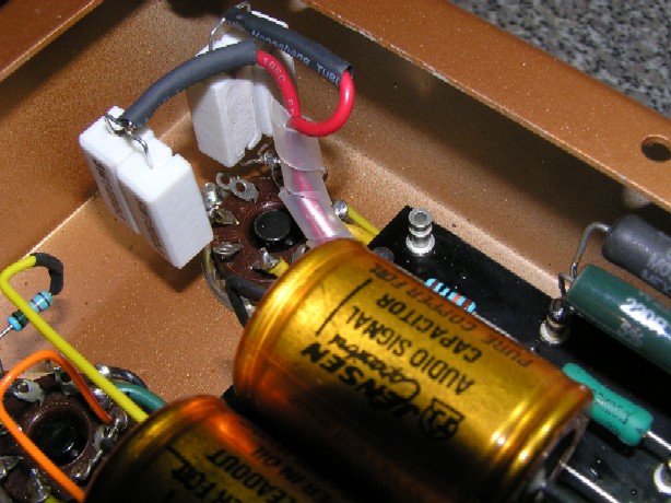

GZ34 anode load resistor calculation -help
I'm a bit rusty on calcualtions.
Hammond transformer 374BX (240VAC primary)
Secondary winding 375V-0-375V, DC resistance measured about 105 Ohms DCR.
GZ34/5AR4 tube rectifier used here.
Current load measured at output to amp circuit = 130mA
Rectification is RC filtering 32uF > 75ohm > 32uF > output = 130mA @ 440VDC
Can any guru calculate what's the optimum value resistors to install at the GZ34 anodes?.

Hi coolmaster ,
To calculate the exact value , I need to know :
1 ) The primary DC resistance ( 240 VAC winding )
2 ) If the DC resistance measured ( 105 ohms ) is
for the total secondary winding ( 750 V ) , or is
for each secondary’s half ( 375 + 375 V )
With these informations , I will calculate the EXACT
resistor value , you need to connect at EACH ANODE
of the GZ34 .
I am waiting .......
Carlos

I've made the measurements again.
Primary 0-240VAC tap in use = 8ohm DCR (total winding)
Secondary 375-0-375 = 99ohm DCR (total winding DCR)
The second winding on each half from 0-375 is not exactly equal, slightly off by 4-5ohms.
My input voltage is exactly 230VAC in operation, incoming supply being regulated by a huge AVR.
Eversince new, its after half hour the tranny becomes a little too hot for my liking and giving me the jitters its bad for the tranny on the long run. I'm sure the circuit hasn't exceeded the current capacity ratings for other windings. The amp is typically a Mullard 5-20. As mentioned earlier, the current draw is only 130mA. Tranny rated at 175mA at HT winding. The DC is C-R-C filtering, 32uF-100ohm-32uF.
Thank you.

Here's the formula (you might have to wait 10 seconds for the advert to vanish so you can view the page)
It's near the bottom under "Minimum Limiting Resistance"
http://www.freewebs.com/valvewizard/fullwave.html

Merlinb: Thank you for the link. Have calculated out the resistor required. Just installed in 75 ohm (2X150ohm in parallel,what I've got in hand) and so far so good after listening to some music for he past hour.

Hi COLLMASTER ,
Sorry for the delaied reply .
Your transformer itself , has an intrinsic natural impedance of
about 69 ohms , the 5AR4 / GZ34 , needs a 110 ohms impe-
dance per plate , so you ONLY NEED to complete this value .
You need to connect ONLY a 47 ohms x 5 Watts wirewound
resistor at each anode of 5AR4 / GZ34 . It’s enough !!! No more,
and your tube rectifier will be correctly protected .
If you are using a higher value , you are wasting energy and
decreasing the power supply regulation .
I hope it helps you . Regards ,
Carlos

Hi all,
Thank you for the valuable guidance.
Carlos: I think a 5W size is likely insufficient, sensing its radiating a lot of heat, and could risk burning out sometime in future from an experience just not too long ago.
Before I posted the question, I had 110ohm (2 x 220ohm/5W to total 10W rating) and for some unexplanable reason, one of the parallel resistors opened circuit upsetting the B+ to go down by 5%. Lucky I spotted it soon and replaced the defective part and all's well. BTW, the amplifier in question is monoblock configuration and current draw@130mA is for 1 block.
As mentioned earlier, meantime its 75ohm/10W on each side and it's still pretty hot after a while..but I reckon it'll be ok. Meanwhile, I'll let it be there for a while till I obtain better quality resistors from RS or Farnel (Vitreous Enamel type or aluminum clad). Currently its run of the mill quality white coffin type from whatever spares from my stash of usable parts. Due to restricted space underneath, a 10W single resistor won't fit in nicely.

Hi coolmaster ,
If I have understood it right , you have a 5AR4 / GZ34 for each
monoblock , correct ???
In being so , the heat dissipation would be , by the Ohm’s law ,
P = R x I ²
110 ohm x 0.13 x 0.13 = 1.86 Watts ( resistor set will be VERY
HOT ) , but you have a 10 watts total dissipation allowable , then
a safety margin > 5 , that is a GOOD number .
75 ohm x 0.13 x 0.13 = 1.27 Watts ( resistor set will be HOT ) , but calculated the same way as above , the safety margin ~ 8 , and that is an EXCELLENT number .
BUT if you use 47 ohm x 5 W , as I had said , then 47 x 0.13 x
0.13 = 0.80 Watts , then the safety margin would be > 6 , that is
a VERY GOOD number , however the resistor would work A BIT
HOT , but you would not need to worry about that .
As a rule of thumb , in my designs , I do assume that a safety
margin > or = 5 , is OK .
Choose a good quality wirewound resistor , and keep it away from heat sensitive parts , rather in a place where the air can
flow by convection .
Any doubt , feel free to ask . Regards ,

Let's see.
Sitting there now is 32uf + 32uF/500V filter cap (F & T German)there. I've got another (2 EA) spare 50uF + 50uF/500V cap..how much better or stress anything by replacing the former?.
An affordable Sovtek 5AR4 or JJ GZ34 is resident most of the time, as I believe current production tube rectifiers are equally good as expensive NOS types, which revealed NO audible difference to my ears, unless I'm fiddling and altering component values at the rectifier circuit.
