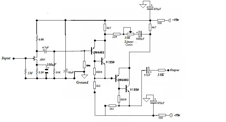

Hi Guys, I am thinking about makeing a basic Guitar preamp for putting into my next DIY Guitar amp...
My last Guitar amp used Opamps for the Preamp stage and it sounds Pretty good but the sound is a Bit Muddy and there is Too much low end even after eq"ing out the Low end completely so I was thinking a discrete Preamp might have a More dynamic sound and more sustain and Clip more gracefully.....
So I threw together a simple schematic Borrowing some ideas from other designs (as I am not Experienced enough to Design a disrete preamp by myself yet but am pretty good with opamps)...
So could anyone with more experience than me tell me weather this design will work, Or at least has a good chance of working???
and/or tell me how to make it work or point me to one that will work.....

Just from top of my head:
- J201 is a bad selection to use in that "Till" FET circuit. Use something like J309 instead.
- You can't just lend a circuit and expect it to work without biasing to adapt the new supply voltages.
- Why have 1k? resistor in parallel with 51 k resistor?
- Why not use dual supply for the first stage as well?
- Why do you use Sziklai PNP stages?
- I simulated the BJT section of the circuit with pspice and it does not work. What were you trying to achieve with that strange configuration?

Like I said before I don"t know hardly anything about Discrete designs....
If it won"t work then it won"t work ....
Can you point me towards a not to complicated discrete design for a Guitar amp Preamp that will work....I don"t like useing Fets as I have no real Idea of how to properly Bias them, Transistors seem easier to use but they don"t handle the High impedance Input from a guitar very well.....
What design would you suggest??

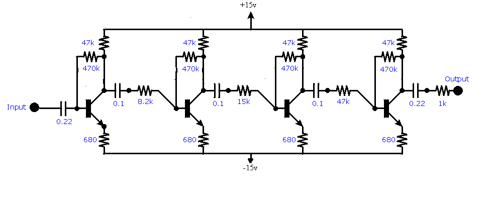

PS: would this curcuit work OK...
Nothing to esoteric or complext But Like I said before I know very little about useing Fets and Transistors so for me to throw together a couple Common emiter stages by myself is Just looking for Problems as I wouldn"t have the Slightest clue as to how to go about it....
Everything I have designed up to this Point have been simple Inverting/Non inverting Opamp Circuits and some Microphones and distortion pedals.....
I do have a Bunch of BC550/560 and some 2N4401/2N4403 and some 2N2222 and some J201 fets and some 2N7000 Mosfets and a Bunch of other Transistors but have absolutly no knowlege on how to use them in a Curcuit......
Cheers
Then I guess it's just time to start learning... The circuit you attached is a start and probably works with certain supply voltage values but I suggest you start by creating one simple gain stage that works and then advance from there once you understand the basics of the circuit.
