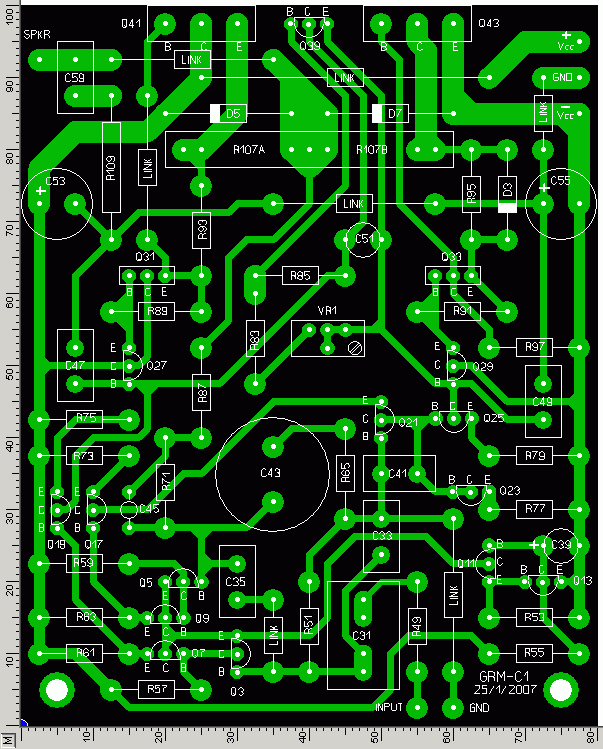

Anyone with the right tools to layout the board for the Cyrus?
It would be the first good deed in 2007 for these poor guys who don't have them and struggle to have a decent board when they want to build an amplifier!.....
I usually do my boards by hand, trial and error, but this one....ah,
too dificult, I already tried...

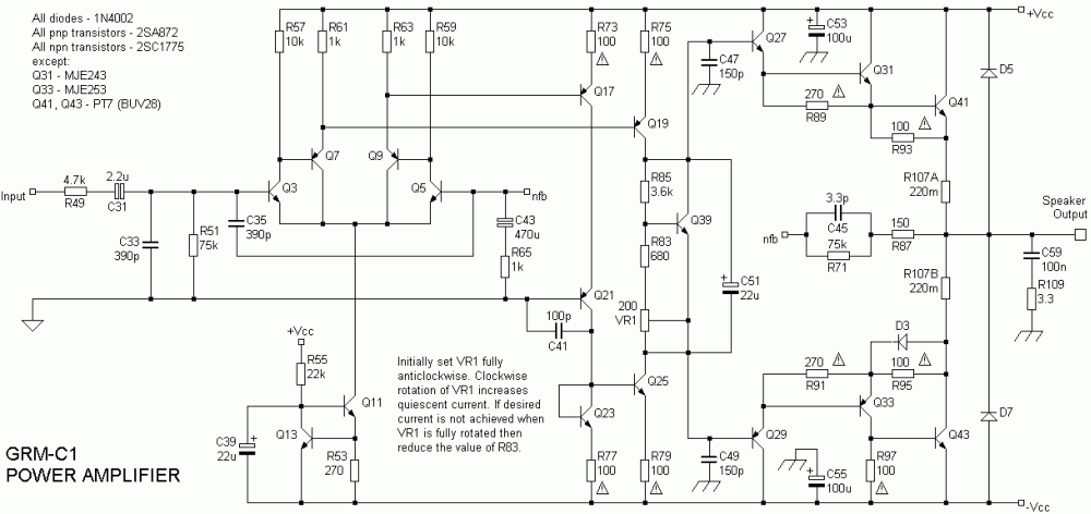

jmateus said:
Geoff is there any chance to get the layout of the power amplifier only?
Geoff said:
I would like to help but unfortunately I am not aware of the layout being available anywhere. I don't have a digital camera ......

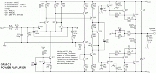

I may not have a digital camera but I do have pcb layout software so you may be in luck!
I have attached a slightly simplified schematic (but with no loss of performance) for which I have prepared a preliminary layout. It goes without saying that that there is no guarantee for this layout and that it will need a careful, independant check prior to being used.
I have added a preset to enable the quiescent current to be adjusted and have tried to allow some flexibility in the selection of the input capacitor C31 (Cyrus used a physically small bipolar electrolytic) and R107A/B (Cyrus used a three leg dual resistor). Other than that, component footprints were taken from the Cyrus pcb. I have assumed that the output transistors would have a pin spacing similar to that of a TO-3P package rather than the TO220 used in the Cyrus 1.
It might be worthwhile asking a moderator to separate out the Cyrus related posts from this thread into a new one with an appropriate title.
PS I had to resize the schematic to allow it to be attached which reduced the quality. If you want a full size version please email me.
Here is the pcb layout. The physical size is 100 x 80. I started with a component placing identical to that on the Cyrus pcb but ended up making various changes to allow space for components that were mounted elsewhere on the Cyrus board (eg the output Zobel network) and for a physically larger input capacitor etc.
When the layout has received an independant check, and any necessary modifications have been made, I can supply a high-res image of the copper pattern
compensation consists of only c35, c41 & c45.
I think you should add a few more locations for C and RC compensation BUT NOT a Miller comp cap.
C43 is too large.
C31 limits the input filter to <=165mS.
C43 can usefully be reduced to 220uF or 470+470uF in series back to back
This will allow a lower value of PSU capacitance to be used.
470uf gives 470mS requiring the PSU to be set to 660mS and for an 8ohm speaker that amounts to +-80mF on each channel. Simply too much.
R83 might be a little high, try 560r.
Swap c59 & r109. That allows an alternative feed back tapping point from the top of c59.
Q1.
is there any advantage in reducing the negative feedback resistor values and Zin? to maybe 47k or even lower? Then the 470uF may be required.
Q2.
why have you removed the thyristor protection? It is the ONLY protection to prevent catastrophic blow up.
Compensation is as per the original Cyrus 1. I agree, NO Miller cap (one of the reasons why I like this circuit)
C43 is too large.
The Cyrus uses a 470uF 6.3V bipolar electrolytic for C43, hence the large footprint (and no need for back-to-back). Of course a lower value capacitor can be used in this position, given the value of the associated resistor, but with the value given phase change does not begin until around 30Hz which may be why it was chosen.
There is a note on the schematic regarding reducing the value of R83.
The original has C59 and R109 the other way round. I had to reverse the order so that the components would physically fit on the pcb. The alternative would be to mount the Zobel across the output terminals.
Q1.
Not if one wants to follow the original design.
Q2.
Because it caused too much complication with the board layout and I was not prepared to spend too much time on a pcb design that I would never need to use (I already have four Cyrus 1s of various vintages).
Also, the pre v07 versions of the Cyrus did not have this part of the circuit and they have worked well enough over the years. An added factor is that this feature does not appear to work as intended. A friend's Cyrus lost its output transistors due to a near short across the output terminals despite it being a v07 with the protection circuit fitted.
