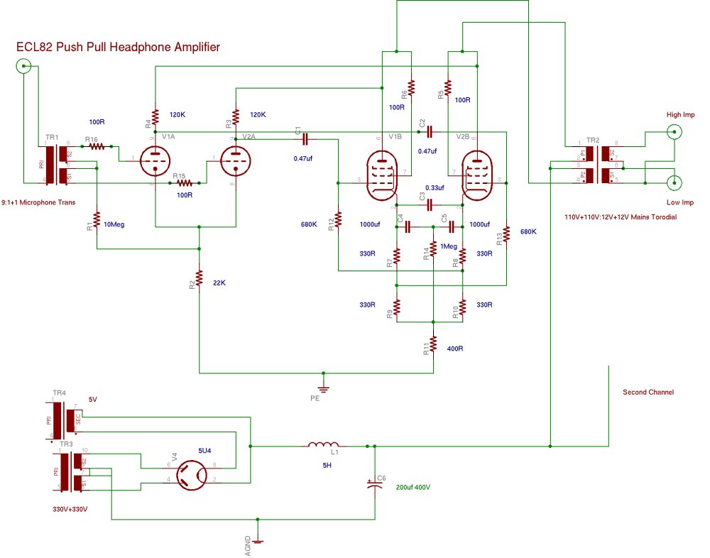

I have used the ECL82 in a few projects. I also had a Leak Stereo 20 which used the EL84.
My experience of the Leak was that it has a very rich smooth sound, which I understand is common to most EL84 amps.
I have made a headphone amp using the ECL82 and also have used it to drive interstage transformers. I found that it is tremendously detailed, but a little zingy and bright. In the end I had to introduce a small amount of loop feedback into both to tame the top end. I suspect that its the triode stage of the ECL82 which is the real weak link, but I have no way of been certain.
If building from scratch I would guess that a better result could be achieved with the EL84. The ECL86 seems to be a superior brother of the ECL82.
ECL82 need handling with care.

I have just been talking someone through a fully differential design with input transformer and input stage grid leak bias using the ECL82, it also uses plate to grid feedback with the triode voltage supplied through the feedback resistor. He is happy with the test rig and wants to build the full amp. I wanted to see how it performed as a speaker amp rather than a headphone amp (as designed originally). On my sensitive speakers it sounds as good as my class A 25W 807 amp - so i am happy with the result.
My only concern with the ECL82 is the triode section which I feel is easily overloaded at the grid and needs careful handling if not to sound harsh. This is why I used a step down input transformer in my design. I used microphone transformers with a voltage ratio of 9:1+1. This works for me in my application as a PP headphone amp - but something like a 3:1+1 would be more appropriate for most people. Heavily loaded the triode has a gain of 70 which is massively excessive for almost all designs not using unreasonable amounts of cathode feedback.
Shoog
Shoog

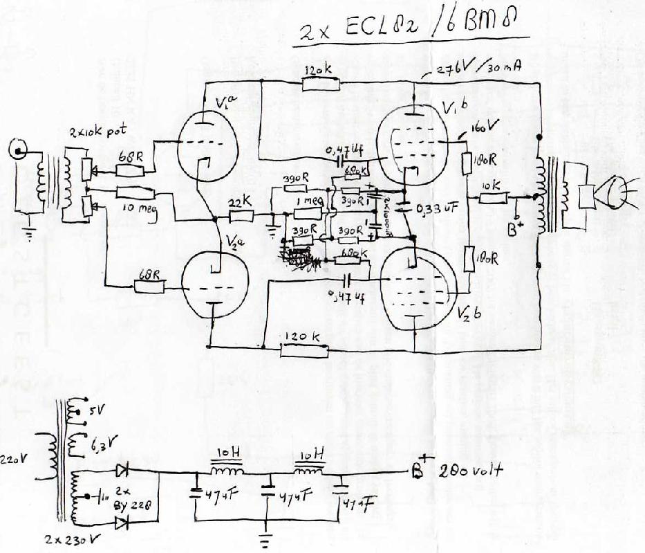

This what I tried
I simply took the design of Shoog's headphone amp and with his help I fiddled with some component values to get 30 mA through each ecl pentode. I used small (4 x 5 cm) OPT's formerly used by the Stoetkit jr.
The differences with the Shoog headphone amp are that I used 390R cathode resistors (to be honest I didn't have 330R in the house) and that I left out the common 680R resistor in the tail. I also used 2 x 2200 uF/50 volt under the cathodes because that value was available in my closet.
It worked out that by changing the resistor to G2 you can settle the Ia.
Changing it to about 7K gives you about 35 mA through each tube.
