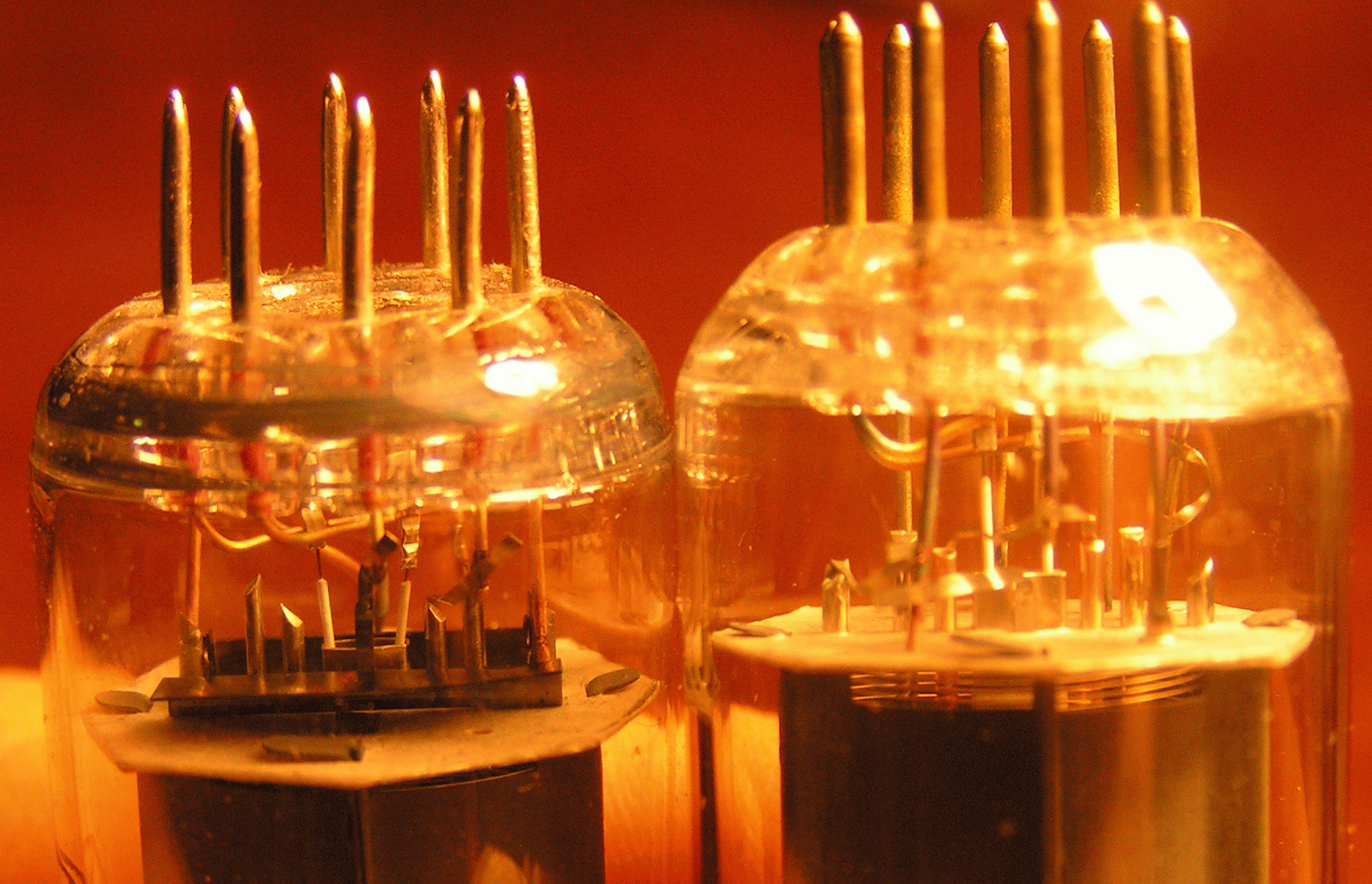

Do you see any differences between the 2'nd grid in 6P14P (EL84) and 6P15P?
I don't...
People believe that 6P15P has weak 2'nd grid, while I believe that different specs are given for different guarranteed results because 6P14P (clone of EL84) was sold for audio, 6P15P was sold for linear video amplifiers.
What do you think?

Hi Anatoliy,
Please check here and here .
They very clearly put a limit of 150V on the screen. So it is "weak" as you say. You can't tell just from pictures, but the manufacturer has rated them that way for a reason.

anatech said:I sure did, did you?
No.
I turned what you said around a little.
No. I said that different grid voltages give different plate curves of the same toob, and this can be the single reason for different specs since toobs were sold for different applications.
If some tubes work well at higher screen voltages, and some don't it would point to very loose quality control from that manufacturer = junk tubes.
Did you try them on higher screen voltages? Are you sure they don't work the same as 6P14P?
I did not try, but I am not sure.
If Tubelab did not (I know he is famous torturer of toobs), I will try and report my results. I suspect that 6P14P/EL84 with up to 200V on the 2'nd grid will have the same excellent linearity like 6P15P.

No, it was not off-topic, the topic is about 6P15P as a some kind of special tube about which maal1605 is not sure.
I am neither, but I believe that it is EL84 with additional lead for the 3'd grid, and with different specs to guarrantee better linearity.
Another similar example is 6P3S-E that by specs may be regarded as very weak version of 6L6 with 5W output only.
In my amps 4 of them (2 in parallel) give 80W easily, no difference between them and 6L6GC in the application.
Where is the point?
The point is in specs for much longer guarranteed by manufacturer life than ordinary 6L6...
I believe, 200V limit on the 2'nd grid of 6P15P is from the same opera, to guarrantee specified linearity.
But I am not sure, I need to check before drawing the conclusion.

Curves are ideitical...
I suppose some guys in Soviet institute got a huge premium for "Development Of New Very Linear High Frequency Pentode"
maal1605, you will get no differences between 6P15P and EL84 so better save money and use what tubes you already have.

Ok, thanks . But i suppose i have to take care of the 2nd grid voltage limit of 150v? I read about an amp where theese tubes is included and the limit of voltage was much higher than the recommended limit. The operation time is set to 3000h. But if the voltage is twice that, i guess the tube is going to die much earlier, or am i wrong? Under the past week i´ve read a lot about this tube. And i have to say, it´s a little bit confusing. Because som amp-builders says the EL84´s is 100% replaceable with the 6P15P-tube, and some says it´s not . Anyway, do you have any suggestoins about a push pull amp with EL84 and the 6P15p tube is useable? I doesn´t have to be to complicated. Some good links maby ?

I don't think so.
Devices with electrodes of the same size and shape that produce the same curves can't be different. Except probably more precision grid alinments in 6P15P.
However, I may be wrong, and the 2'nd grid in 6P15P have more turns than in EL84 and it is invisible through the hole in plate. I don't have dead tubes to break them and carefully inspect what is inside, so can't guarantee. But it may be tested by comparing 2'nd grid current curves.
